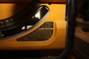

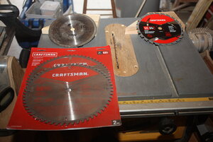

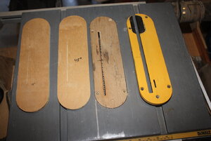

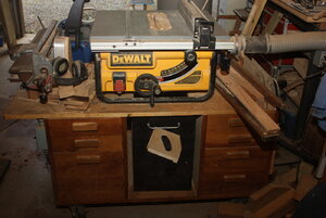

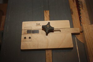

I had a 10" contractors table for a lot of years (about 30) until parts failed and were no longer available.
As I was looking for a reasonable replacement, my son-in-law gave me a Dewalt 10" table-top saw. I was skeptacle at first, but I discovered that it is far better than I anticipated. I used my vernier calipers and a good square to precisely set all the adjustments as described in the owner's manual. I made some zero-clearance inserts for the saw blade opening and I built a special jig for making repetative cuts of thin stock; 5/64" planks for my lobster boat model. For fine work like that I use a 7 1/4" diameter, thin planer blade that came with my portable circular saw and it works beautifully! That blade is about 1/16" thick and cuts very smoothly.
Current price for the Dewalt DW745 on Amazon is $277, They also have a DW7485 that has a slightly smaller footprint for $279. Yes, there are bigger, and smaller, saws, but I am very happy with this one. When properly adjusted, it is very accurate and it holds its settings very well. There are millions of other options and I encourage everyone to simply consider their needs and choose whatever satisfies those best.

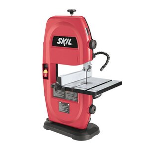

I switched to this, Skil 3386 9" bandsaw. I have various blades but tend towards a 6 tooth, It gives a better finish than the FET, safer to use and far more versatile. I had it shipped to the UK from the States for £120 ($150) I wouldn't swap it for a circular.3386-01_1.jpg
