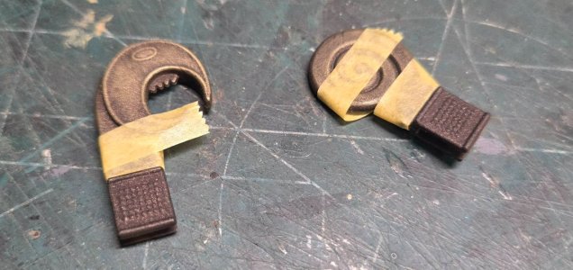

Now I found this picture:
So I decided to print that:
Needs a bit of post-processing, but it will certainly work.

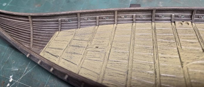

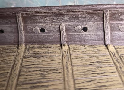

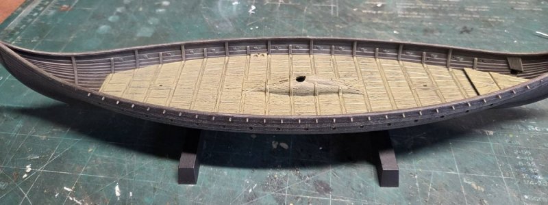

YEAH, LIGHTS! Took a good part of the day and an extra run to Home Depot to pick up some flex conduit, but the new circuit is done. I was able to start back in the model; I detailed the main deck by sanding down the tan to let the black wood grain peek through. I still need to give it wash with water based black or brown. In the first pics, I used a #2 mechanical pencil to highlight the deck board seams. The detailing is done by 000 steel wool. #11 blade and a fingernail file.

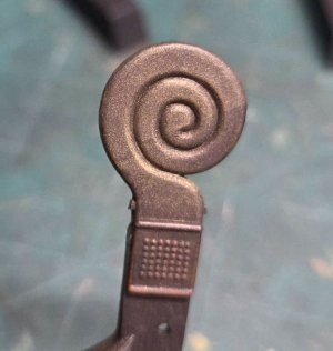

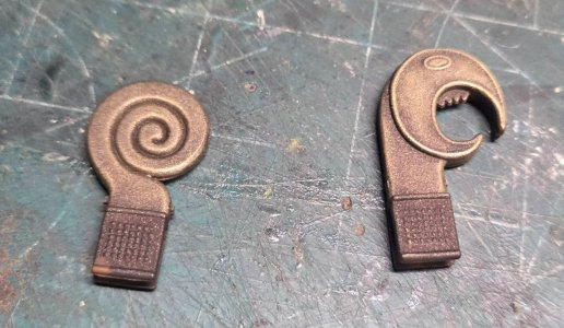

I prepped the figureheads in flat black then burnt Iron, I'll drybrush accents. The bench seats/storage boxes that Jhoanor printed for me got their first basecoat of flat dark tan, they'll be dry brushed and washed as well.

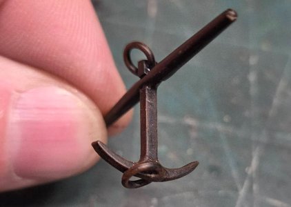

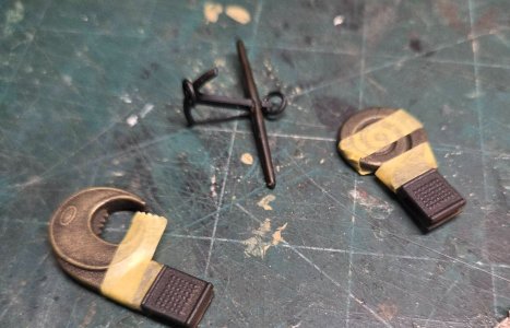

Not much done in the last few days, finished the bow and stem carvings with a drybrush brass over burn iron and the bases were dry brushed with black first then rust. The anchors got a nice rust dry brushing for a bit of corrosion. Hopefully I can finish the hull detail this week. rainy Saturday.......

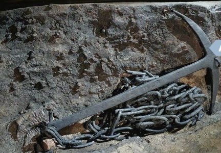

The stock of the anchor is supposed to be made of wood I think. Shouldn't it get a distinctly different colour?
I too thought of that, but I wanted to do a wood and rock anchor, but another modeler pointed out they did use iron. I'm not sure what's correct what's correct. I used the Rubber colored paint on the stock as to give it a bit of 'weather proofing' tar, etc.

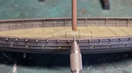

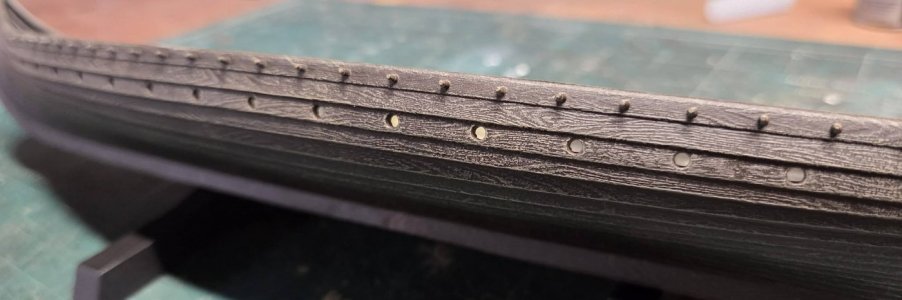

Got the first light color dry brushing in today after the rain, will still need to brown water wash and them dry brush some green on the lower hull for algae. I discovered that Revell carved into the mold an extra detail I didn't notice before. They could have simply left this microscopic detail off, and you'd never miss it. This detail is to indicate a leather wrapping or cladding under the top rail? Looks to be nailed on. The photo with the pin drill is to mark where I need to drill the side mast stays, the Revell rigging instruction left this off, I need to review and measure the placement of the holes before I drill. IF you have the Revell kit, take a look under the top rail for the detail.
Here's a viking anchor, looks like Revell based theirs on that. Its stock was certainly wood.

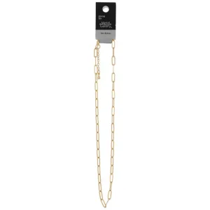

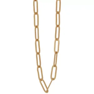

Thanks for the link, I painted the stock the darker rubber brown as if they used a preservative, the metal is black with rust dry brush, do you think they used rope or the elongated chain links, I should be able to find that style at the hobby center.
I was doing a bit of research as to how the mast stays were rigged and happed to find a link to the Viking Museum. In one of the pictures showing the main deck also captured the detail I mentioned above in regard to the indentations on the Revell model under the top rail. Revell did some serious research when they cut this mold.
From what I can tell the stay were attached/tied to loops of ropes that went through holes drilled into the ribs? There is no way to do this on the model as there is not enough room or material to drill through, so I'll need to drill through an area just at the edge of the top rail so the stays have an anchor point, the shields will cover this but I'm trying to see if I can make up a dead loop. Also, I'm trying to decide if I need 3 or 4 stays, I'm seeing pics of both. Anybody have pictures of the stay rigging they can share?
Ok, I've figured out a quick and simple means to create the side-stay anchor point. It's not 100% perfect or correct but it'll do. I'd like to thank JHoanor for printing these and other detail parts. the knot will be glued once set in the hole (You have to love ACC),
I found a chain that looks really close to the chain they had on the real vessels. Hobby lobby has this chain for $3.50 a length.
