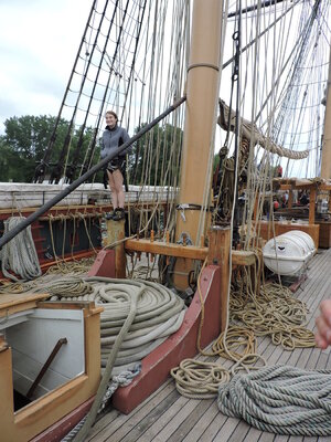

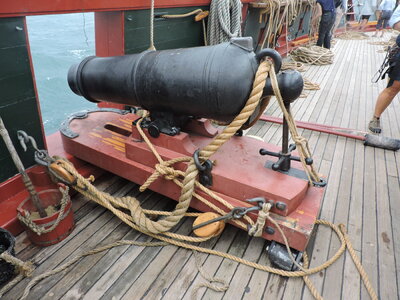

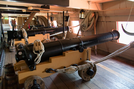

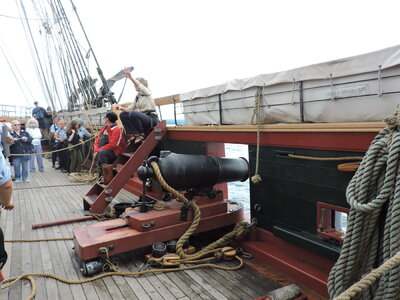

I am with Donnie on this one. The Flemish coils look great and are a testament to the modeler's skill (and patience). However, I don't think they would be used for everyday use on a warship. They look like trip hazards on a wet, moving and dark deck. I attached a picture from HMS Victory that shows what I think is a more realistic everyday rigging for the guns.20170617 - HMS Victory-077.jpg
I am with Donnie on this one. The Flemish coils look great and are a testament to the modeler's skill (and patience). However, I don't think they would be used for everyday use on a warship. They look like trip hazards on a wet, moving and dark deck. I attached a picture from HMS Victory that shows what I think is a more realistic everyday rigging for the guns.View attachment 189446
Yes, this is a configuration for tourist viewing and walking where I believe that the have eliminated all of the deck tripping hazards that they could. Notice the breach restraining hawser is not present or passing through the cast ring on top of the cascabel on this style of barrel and have coiled it on the bulkhead as seen in the next gun over. It appears that they are alternating one side or the other to lay the outhaul tackle over the breach in front of the vent. The outhaul was not meant to withstand the recoil in firing but that is not clear to a casual viewer onboard. Also the did not rig the inhaul tackle at the rear of the carriage as it too would be a tourist's tripping hazard. Given the spacing and gundeck area around each gun we can see how the gun crew could place a line of five or six on each side of the carriage with their assigned tasks in the firing process. This photo is more clear and better framed that those that I have previously seen facing from the other side. Models will always be what the builder wants to present or leave out. It is easier at the larger sized model than the small ones. Just some thoughts. PT-2

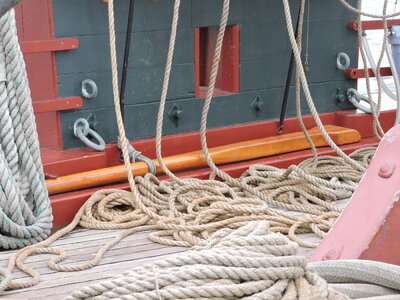

So, I guess I have to be contrary and ask really the dumbest question. All the neat and tidy coils must have been done this way obviously when the cannons are not being used, but in heavy warfare, that would not be the case, but rather messy???
. . . and as a matter of fact, while I was searching for the exact same thing so that I can rig my cannons, I saw a picture of a deck of a ship that even though the Cannons were NOT being used, the lines were just 'heaped' or coils piled up - so, which also begs the question, is the practice of coiling the ropes a 'real thing' or is this just something that a modeler started a long time ago. I am only curious and not trying to start a huge discussion about it. :)
you made me smile Donnie
any working ship i have been on look like this. Those tidy little coils on models are just that its a model thing and not really how things look.
besides that there isn't that much rope used with a cannon to even coil

In regards to PT-2’s observation above that the outhaul tackle was not meant to withstand the recoil, I had been wondering about that very thing. Was it unhooked just prior to firing, and then hooked back up immediately after? I’m also curious how they would relax the outhaul tackle up after running the gun out in preparation for the next volley. working against the leverage of those double and triple sheaved blocks, i wouldn’t think it would be an easy matter of just pulling the hook back.
