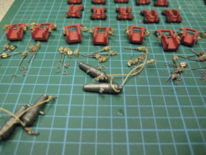

relating to the santisima trinidad, i was wondering, the cannons, cast iron or bronze?, basically i need to know if i go for rust or for patina, i'm using after market cannons since i don't like the ones that come with the kit these cannons have small decorations, wich might point for more recent ones i guess, i'm not super concerned with historical accuracy on this particular model, since i'm changin so much stuff on the kit anyway, but would like to know, if anyone knows this
also relating to cannons, the braces that hold the cannon to the carriage, would be the same material as the cannon?

I would have guessed iron cannons due to the time period but that is a guess as I have no definitive info regarding this particular vessel.

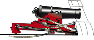

First the gun on the ST where in Cast Iron on the top deck

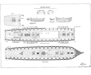

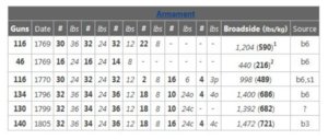

Here the gun complement for Trafalgar 1805
Now on the top deck they where not all gun 16 (24Pd) and 4 (4Pd) of them where carronade there where not enough space for the recoil of regular gun on the launch well section the rest where 14 (8Pd).

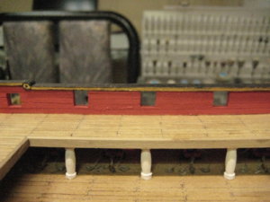

And in the kit they do not mention them but you have to add deck column to support the weight of the gun on the top deck

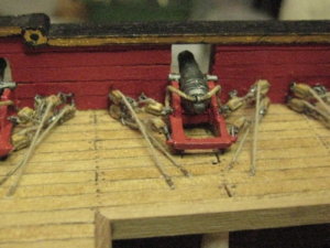

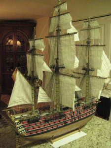

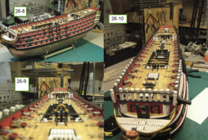

And some picture of mine to give you some idea

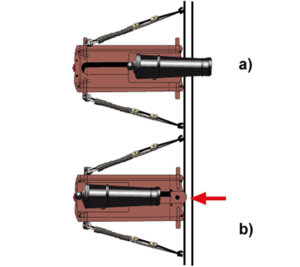

Here i was wondering how i would rig those cannons, indeed carronades make much more sense
Do you have more pictures or even a build log? looks quite good

Forgot another Accuracy detail on the kit it is the chain Block OcCre went literal and supply chain that also have to be corrected if you want
You will find all the info for the parts that I have replace or change in my log. To be honest I went crazy with that ship.
final paint . For the gun I use Tamiya gun metal X10 with a matt finish
