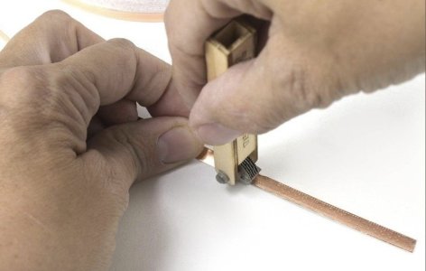

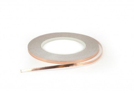

Have a look; I can only recommend the copper tape (5 mm). It sticks really well and the scale would also fit. As this copper tape is also used for the HMS Victory. There is also the embossing roller. You can use it to simulate the rivets. That would be my tip.

Have some 5mm tape and a similar tool that is used for tracing lines on fabric. Going to try and see how well I can do. Plan on making individual tiles and didn't know if 5mm would be right. Thinking the second dimension would be 16mm. Does that seem right?

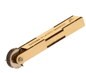

Hey Rebus,
if you want to make pieces, it will be difficult from the tape. I think if you cut it into pieces, it won't be as stable and individual pieces will come off the copper strip.
I also have the rivet roller that you use. I used it for my airplanes to create rivets. It works quite well.
The one from AL is 5-wheeled and has a stamp that shows the pieces simultaneously. That's why it's so good. Take a look at the picture. You don't have to cut any pieces with it. But if you really want to cut pieces, then you really have to switch to copper plates and glue each one on individually. DeAgostini used to make copper plates like this in 1/84, but unfortunately they are no longer available.

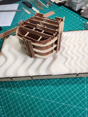

Haven't gotten as much done this week as I hoped. Between yesterday and today, I got the next deck done.20250531_195816.jpg

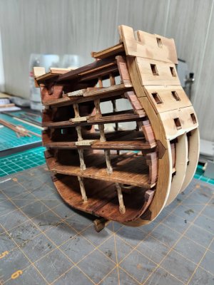

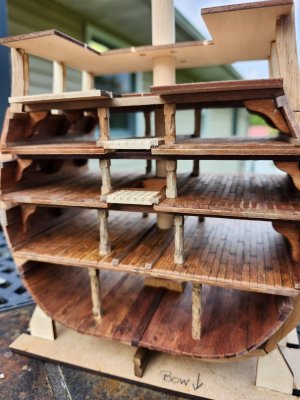

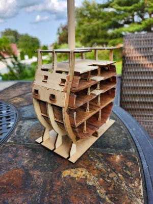

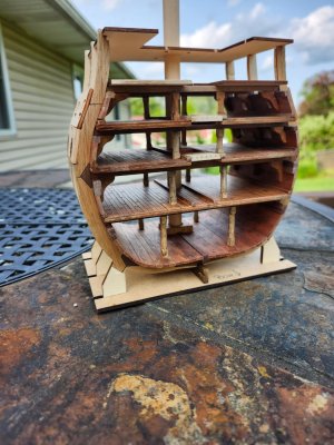

Decided to test fit the remaining two decks with the bottom part of the mast. All seems good. Have been checking with the mast after each deck. Didn't want to be surprised once I had all the decks installed.20250531_182522.jpg20250531_182502.jpg20250531_182450.jpg
The Admiral is impressed and happy with the progress. She thinks it is coming along fantastic and still wants to hang it in the dining room.

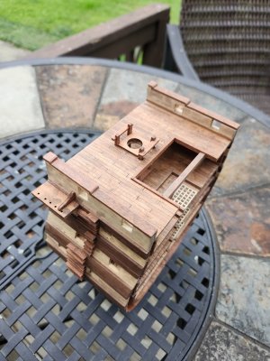

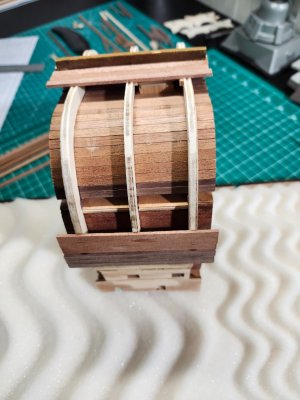

Got all the decks installed today. Then cut it off the jig.
Since then I noticed I forgot the nails for the top deck. Guess that will be tomorrow's first task.
Started the exterior planks hope to finish them tomorrow.
Still thinking about whether I want to copper plate the hull. Soon it will be time to decide.
Finished the exterior planking this weekend and aged everything. Coated with a matte finish. Have decided not to do copper plating for the hull. The Admiral would like to see the wood not copper. Since she purchased it for me to build and wants to display it in her dining room, I agreed with her to leave the copper plating off. ROTF I like to see the wood also. For both of us, our undergraduate degree is in forestry.

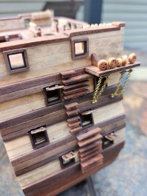

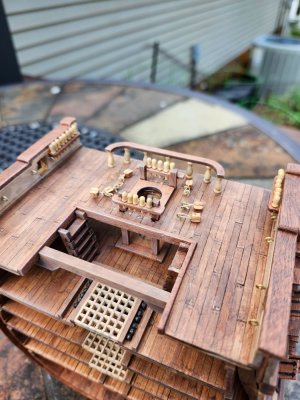

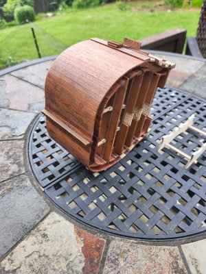

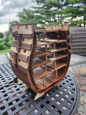

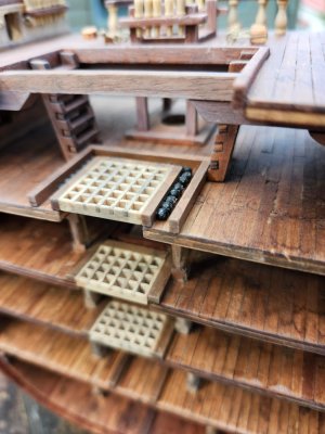

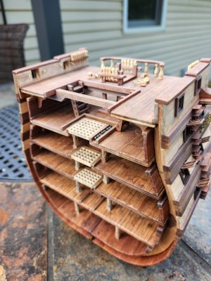

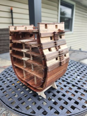

Here are some pictures for the current state of my build. Got all the port hole covers installed. Finished the deadeyes and chains. All belay pins are there and blocks mounted to the deck. Aging of all surfaces and then a matte finish was added. Now for the cannons and barrels then I will be able to add all the internals.
20250615_173843.jpg20250615_173852.jpg20250615_173914.jpg20250615_173925.jpg20250615_173938.jpg20250615_173903.jpg
View attachment 525971View attachment 525973View attachment 525975View attachment 525976View attachment 525978View attachment 525974
Hey Rebus,
that looks great! ThumbsupQuick question: Are those fingerprints on the side of the boat? Looks like they are dark stains?

Rebus, you model looks great. I especially liked how you veneered over the outer frames. I really dislike the use of plywood in most kits.
I wonder how OcCre expects people to belay a line, let alone hang a coil, on those enormous belaying pins. Perhaps you could rig her with dental floss?
Not only do the belay pins seem too big, I thought that eight of them together was a great number for the space on each bulkhead. Part of thing I wonder is since it is a cross-section have more pins been pushed into a smaller space for one mast of rigging. Guess I will find out in a couple of weeks when I start the rigging.
