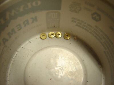

Can you buy small brass sheaves like in the picture? I made these but they are a PITA and the results are kinda inconsistent.

I'd buy a brass round rod and sliced as many sheaves as required.
That's what I've been doing on my lathe and I couldn't get the thickness consistent. I would have to throw away half of them. I think my lathe is a little big for such small stuff or maybe I'm just incompetent. I'll still have to make a few of the larger ones.
how many do you need? I have a mini lathe with a digital read out with .01mm accuracy. I can't promise,but if I had time and depending on how many you need, I might be able to accomplish this. I have made these before for some Bitts. The sheaves had a groove too. I think they were like 2mm wide or 1.5 wide if I remember.
I would need the diameter and width and also the hole in the center. I have to check my raw stock too.
Thank you very much Donnie but I think I have enough sources now. I also keep discovering new places that I need them, so I really don't have a clue how many or what size. Building without plans is very confusing/surprising.
Nice job on those Donnie :), especially in steel. I found that the hole would run off if I tried to do more than one at a time. That was probably a dull drill, but I never thought of that at the time. The big problem I had was trying to get them the same (and accurate) thickness. I was using the depth gauge on my digital calipers measuring from the end of the stock to the cut off tool. No matter how I did it turned out to be a crap shoot. I actually found that I could get them closer by eye than by measuring. I was going for .050" to fit in a 1/16"(.063") slot. They were too big or too small. I'll try again when I'm more in the mood.
