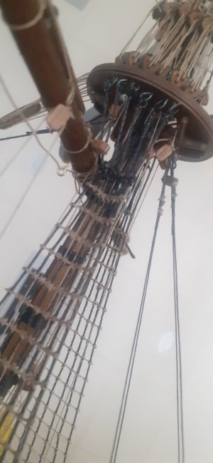

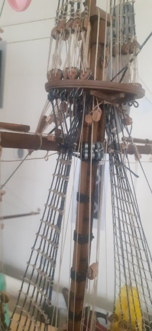

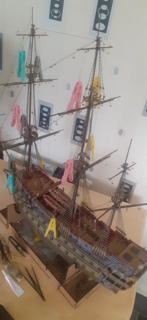

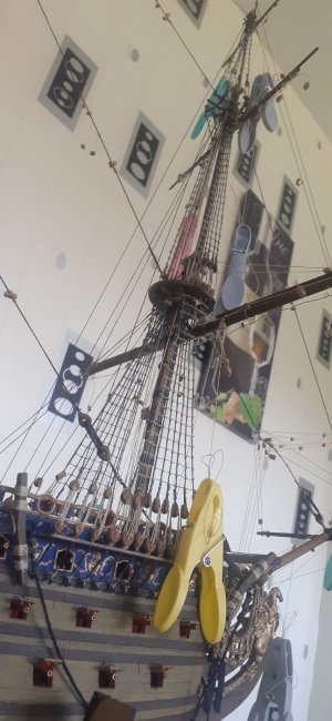

It's been slow moving here, however I have completed all the ratlines for the masts, I am now rigging the futtock Shrouds before adding the ratlines to these also, after this I will be rigging the back stays for each mast before I can start making my sails, still a way to go, time consuming regards to my new job and other issues, so hopefully I can make more time in the near future.

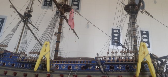

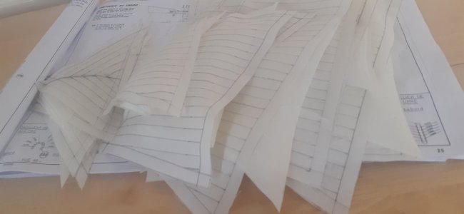

All the backstays are now complete on my Soleil Royal as is the rigging to a point. Next up is measuring and drawing the sails on to cloth, after which is hand sewing all the detail on to them. Roughly 14 sails to do as I won't be adding the studding sails as this would make the width too much for where I want to display the ship when finished.

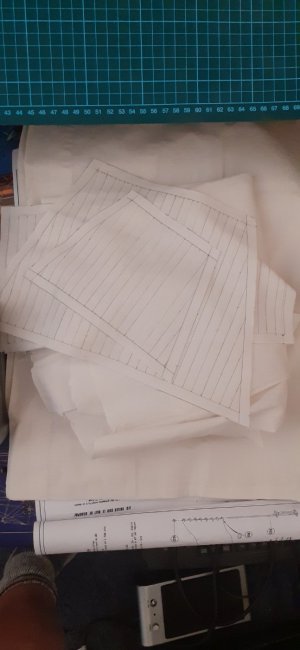

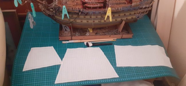

Well that's the 14 Sails measured, drawn up and cut out next step is the long process of Hand sewing all the detailed lines etc.. I've also made the flagstaff out of wood with only a little aid of the plastic support, as well as 2 brass halves of Fleur de lys bonded together, next will be a little paint and weather for the support and staining of the wood.

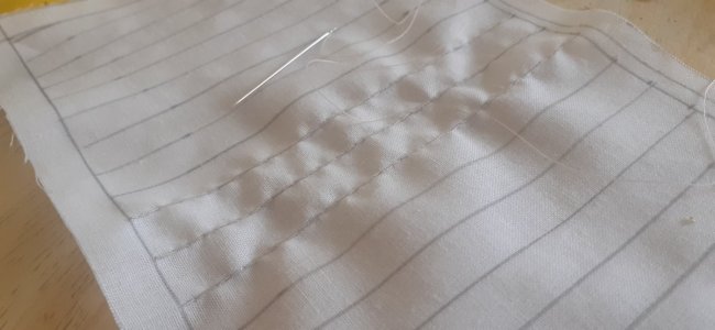

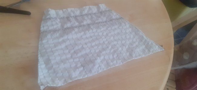

Nothing much to right up about apart from I have now completed hand sewing 4 of the 14 sails I intend my ship.
Updates now will be few and far between as it's pretty pointless putting sail completion updates everytime one is finished. Hopefully I can get these done and rigged up before the start of September in time for the Model/show exhibition I've been invited to display at, if the ship isn't finished it can still go on display as a Work in Progress.

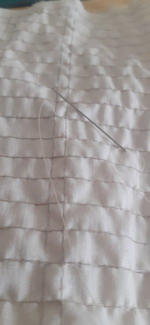

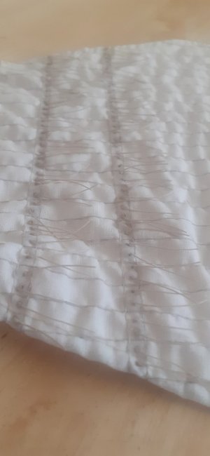

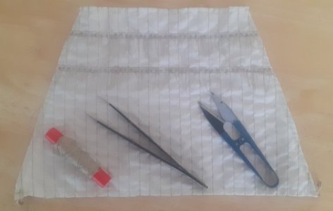

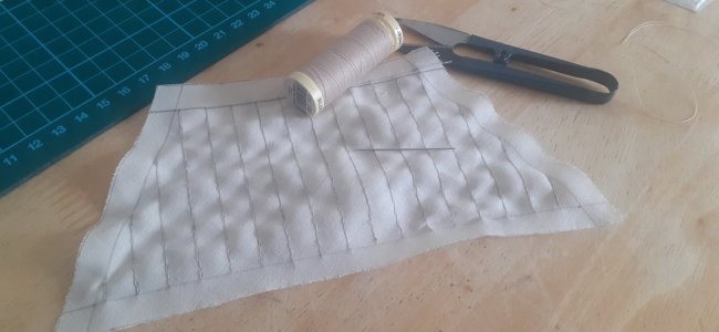

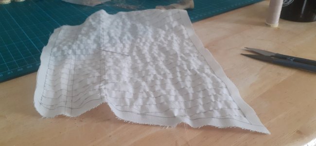

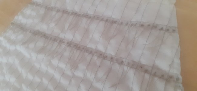

A few photos below...
You’re hand stitching those? I thought doing it with a sewing machine was a challenge! o_O
Yes I always hand sew my sails, one of the things I learned to do as a kid because health problems, although I have operated some Machines in my working life I wouldn't know where to start with a sewing machine lol.. I much prefer the realistic hand sewn look to smooth Machine sewn look, just my preference of course.
