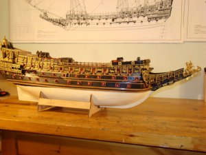

Well, well. Between family, work and other stuff I also did find some time to be at the shipyard.
All gun ports are finished and painted in red.
I also continued the second planking on the upper hull. Hopefully I can finish the upper hull this week.
Started with the planking of the lower hull. It is quite time consuming, because half of the planks have to be cut or sanded individually. But on the other hand that is what it makes intersting.
picture of the bow area.
picture of the stern.
