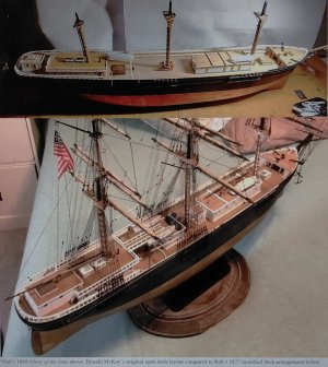

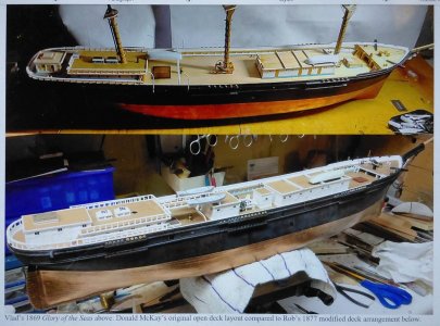

Thanks Gunther. They are of our (Vlad's and mine), build of Glory of the Seas. He built her as designed, I built her at the height of her modification period.
Rich needs some images for his next NRG/MSW article. Trying not to side swipe this log too far.......but it is relevant to the subject.......I think.Cautious.

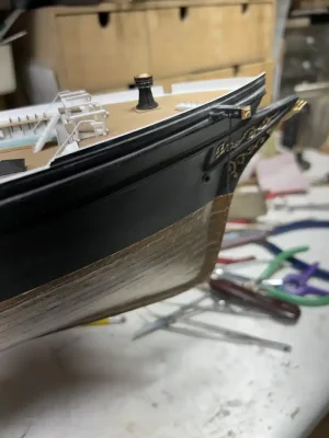

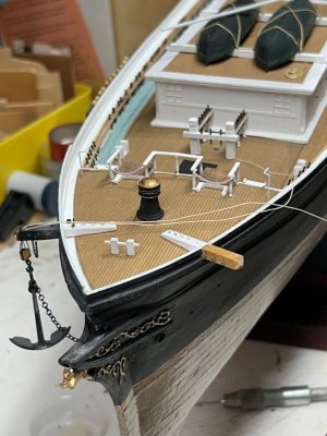

Here are some closeup of my corrected forecastle after and during reconstruction.

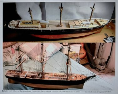

Rob, I seem to have misdirected the issue. Per Mike's suggestion, in my 3rd article, when appropriate, I'm contrasting Vlad's original 1869 Glory of the Seas deck layout with your 1877 revised deck layout to reveal how dramatically her appearance was altered in just 8 years. It has very little to do with forecastle heights. I scoured your site and the best comparison angles I found I shared here first. I did find one with the same angle but it's in a busy bedroom and I wasn't sure you'd appreciate me putting that particular pic in a magazine. It might be

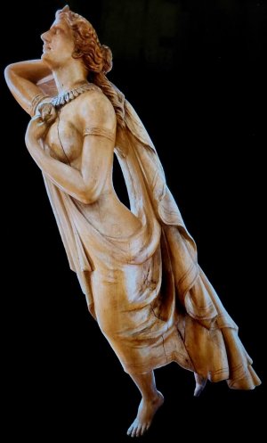

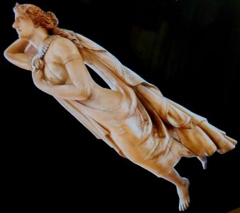

embarrasing. If it doesn't just let me know and I'll share that one to see which looks better. For now, I just added a one-line disclaimer that at this point in your build, we had yet to discover the forecastle height error. Bonus: I managed to tilt my laptop and get a picture of figurehead Athene at her proper angle so that she's looking forward.

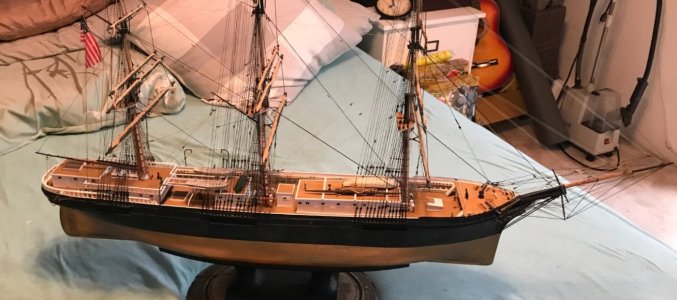

Rob,
Last "side swipe" I promise and for the inconvenience, I will share an interesting discovery. Here's the other bedroom scene, which while it has your Glory raised forecastle I think the other one with just the 3 lower masts is clearer for deck comparison purposes. FYI, I've been working on article III going on 2 years now...

Great article find...for sure Rich. I will review my own images (NOT posted), and see if I have any other of her from above so you can use that too if need be. Sorry...I did think you were seeking the common correction Vlad and I had done on our separate models. I see now.

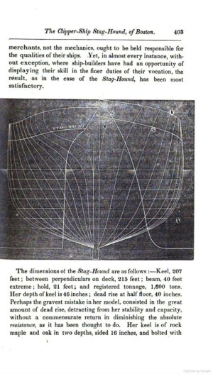

Meanwhile **** STOP THE PRESSES!!!! **** I found it!!!! The elusive, AUTHENTIC 1850 CORNELIUS MCKAY CLIPPER STAG HOUND LINES PLAN!!!!!
I am in contact with Elias Trout, MIT Museum Collections. I've already signed a confidentiality agreement and paid a $15.00 research fee. I'm in reciept of a low resolution print with a large diagonal watermark on it. You can also see Cornelius McKay's signature. There's a starboard sheer plan, bow and stern body plan and ship's hull plan, as well as a small sail plan in the lower right. MIT doesn't authorize release online of the high rez watermark free document. I'm waiting for their approval to share the lower rez one. From digitally stitching images into one, it's immediately clear that both Chappelle, who's way off and Crothers have her stern profile too round. She's closer to the profile of the Flying Fish.
McLean clearly states her stern is elliptical. Pretty much anything other than round. Slightly sharper curves at the outer edge and softer curve in the center. A reverse paraboloid.

Since we wisely reconciled our plans with the Cornelius McKay 4' half-hull model, discrepancies with the actual plan were almost entirely eliminated. About the only difference I saw when I made a full-hull composite was her stern being less rounded than any other plan. I'm just thrilled to finally have her fully authentic, accurate lines. I plan on tracing them to produce plans that exactly match but do not violate MIT-Museum privacy policies.

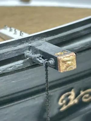

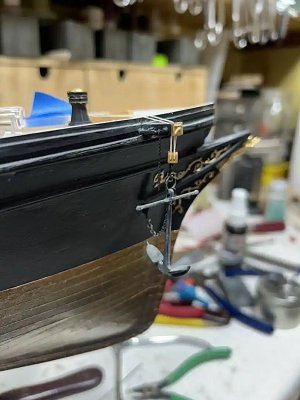

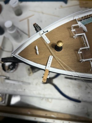

I finished up the starboard cathead and splash rail.

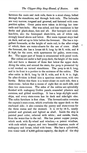

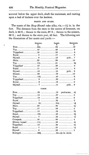

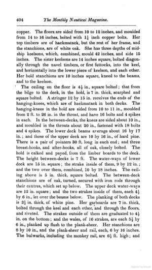

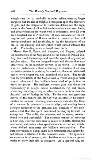

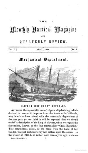

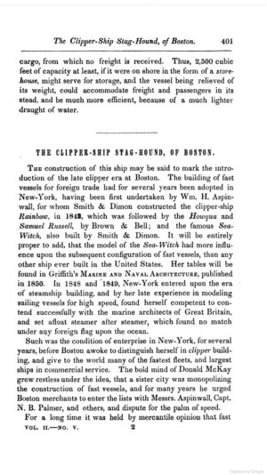

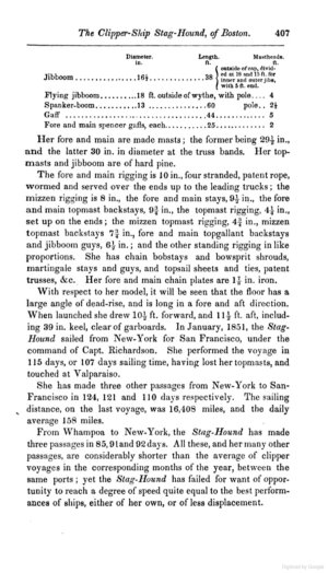

Here's an April 1855 Monthly Nautical Quarterly Review Stag-Hound article which I'm unsure if I shared before. This one confirmed the Hall specs that her masts raked 1 & 1/4th" instead of the incorrectly reported 1 & 1/2" in the Boston Daily Atlas. We learned from the Cornelius McKay handwritten notes that her bowsprit raked at 4.2" and not 4 & 1/2" as also erroneously reported in the McLean article. I attribute these to "typos" and not to McLean himself. Now that we finally have her precise plans, we can clearly see her accurate mast rakes, placements and bowsprit rake. This emphasizes importance of multiple sources to confirm accuracy in research.
