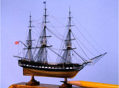

I think the solution to overly large knots is using finer thread and more adhesive than knot. When the sizes get smaller, "faking" the detail is often a challenge to one's creativity. It was a mystery to me how it was done until I read Lloyd McCaffery's book on building miniature ship models and discovered that he doesn't use thread at all, but rather very fine wire and tiny punched out pieces of paper sandwiching the wire connections to make his blocks. (See: https://www.amazon.com/SHIPS-MINIATURE-Classic-Manual-Modelmakers/dp/0851774857?ref_=ast_author_mpb)
See also:
https://static1.squarespace.com/sta...1632346739526/Lloyd+McCaffery+book+part+1.pdf

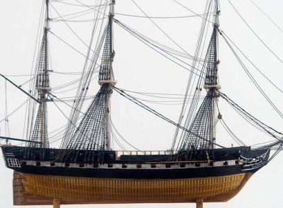

USS Constitution: 1:768 scale
Model above greatly enlarged:
