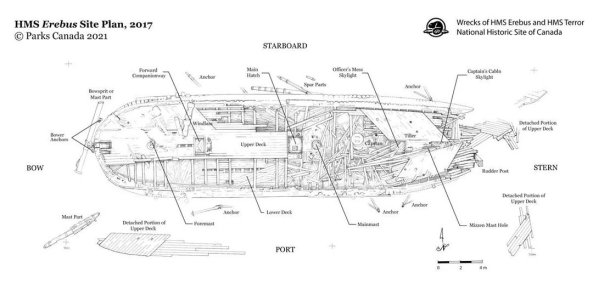

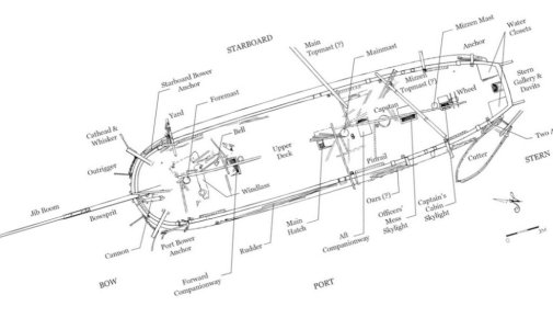

To what extent was the ship actually adapted for the expedition?
Documentation includes information that the upper deck received additional transverse reinforcement and insulation between it. This is included on the ship's occre, but it's not visible on the wreck.
The same applies to reinforcements, which are not recorded in the documents. It's possible that the workers added additional beams "on their own," without any documentation, which was not uncommon at the time.
I recommend delving deeper into the history of the ship and the falsification of documents by the Admiralty. This was too exclusive an expedition, it had to succeed.
The ship sank, but the documents remained...
They is much speculative documentation regarding the modifications to Erebus and Terror. But Erebus has less online than Terror.
Prior to the ill fated voyage, both ships had extensive remodeling for the stern/rudder area to accommodate the new retractable propeller. The decks were re re-enforced originally ( as these were "bomb" ships with heavy mortars on deck., but double planked prior to the voyage. The ship was a bomb vessel, with an extremely strong hull, built to withstand the impact of explosions. Iron plating was added fore and aft* on the ships' hulls to make them more resistant to pack ice, and their decks were cross-planked to distribute impact forces. For the Franklin Expedition, water tight bulkheads were installed, and a double lining of copper sheathing was fitted around the keel. ( if you have watched the Parks Canada footage, some details of the decking can be seen on Erebus )
In Scott Cookmans book, ICE BLINK, ( Really great book to read) he refers to Barrow and mandating other modifications. These included: " the ships sides which were 3" of English oak, were doubled with two layers of African oak, each 1 1/2 inches thick wrought diagonally against each other. In turn this weas overlayed with with two layers of Canadian elm, each 2 inches thick, again wrought diagonally.

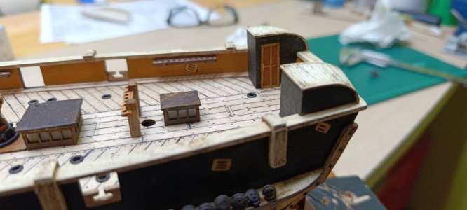

By the way, the Terror OcCre kit did not include the stern water closets and curved davits as confirmed bt the underwater photos of Terror.( I fabricated those and added to my build)
Some remaining questions are: did the iron plating extend along the sides just below the ice channel? Were all hatches "doubled" Did Terror have 9 ships boats or 6.
Matthew Betts book, THE TERROR gives much good building information.

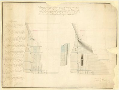

Yes, they're signed and dated by Colin Mcquirk, 4 of them are from 1977 and 1 is from 1980. I didn't find out much about him online except that the city of St. Mary's (ON Canada) has some of the same drawings in their archives. I don't know how it worked back then as far as prints and stuff. These are not numbered as copy's and are on very thick paper. They are what they are. At least they're saved and appreciated now.

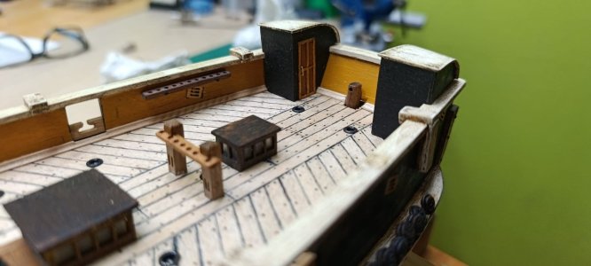

Also, the water-closet structures at the stern were built with roofs and sliding doors opening to the sides. These are not included in the kit and can be easily fabricated for more historical accuracy.

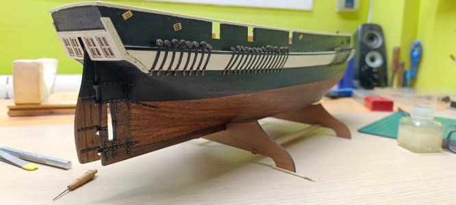

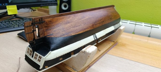

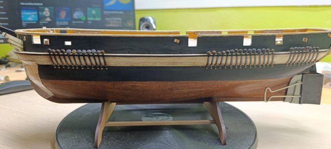

Así voy con mi modelo, con muchas mejoras y siguiendo los planos originales y los de Matthew, un saludo
WhatsApp Image 2026-01-15 at 23.27.34.jpegWhatsApp Image 2026-01-15 at 23.27.35 (1).jpegWhatsApp Image 2026-01-15 at 23.27.35.jpegWhatsApp Image 2026-01-17 at 18.42.33 (3).jpegWhatsApp Image 2026-01-19 at 19.21.00 (1).jpegWhatsApp Image 2026-01-19 at 19.21.00 (3).jpegWhatsApp Image 2026-01-20 at 19.26.27 (1).jpegWhatsApp Image 2026-01-26 at 09.34.24 (2).jpegWhatsApp Image 2026-01-26 at 09.34.25.jpegWhatsApp Image 2026-01-26 at 09.34.26.jpeg

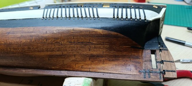

Blunder number one was deciding to use permanent black Sharpie markers to outline the decking planks instead of pencil lead. It worked well, was quick and easy but turned blue a few weeks after I finished the deck with Minwax Polycrylic clear topcoat.
Number two was the armor. I dyed and finished it above the glue line hoping that it could be bent into place. It’s plywood and I’m new and I was wrong. Even thin plywood doesn’t bend much.
