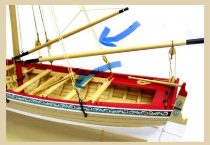

Bob, I CAN identify the error on the Model Shipways longboat model but to do so would be cheating as along with you I was involved with arguing with the kit’s designer. He repeated the error with his own produced Medway Longboat kit.
Hint. The error makes a common small boat operation not only dangerous but impossible to perform correctly.
No, those are running backstays. When the boat tacks one crewman is tasked with slacking off the leeward backstays while another tensions the windward one. I have sailed on several boats with this arrangement.
Look Closer!

I haven't sailed much, but I'm going to take a stab at this one. Does it have anything to do with the fact that the tiller passes above the sheet traveler rail, rather than below it? This would effectively foul the tiller every time you jibed. (I hope I got my terminology right.)
Look Closer!
Roger

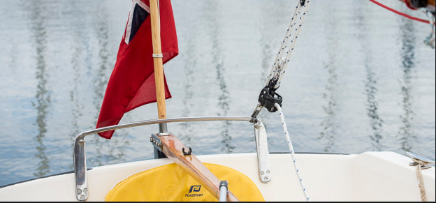

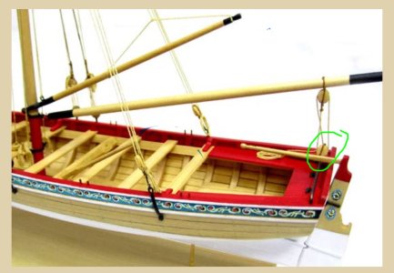

The tackle of the sail can’t be easily changed by jibing it is crossing the ruder it should lie aboe the ruder.further the angle of the backstays limits to much the sail freedom therfore they should be closerto the mast
I haven't sailed much, but I'm going to take a stab at this one. Does it have anything to do with the fact that the tiller is passes above the sheet traveler rail, rather than below it? This would effectively foul the tiller every time you jibed. (I hope I got my terminology right.)
BINGO! Exactly correct. When tacking to sail to windward, the helmsman pushes the tiller to leeward, turning the boat to tack through the eye of the wind. as the boom moves across the centerline when passing through the eye of the wind, it pulls the lower mainsheet block across the sheet horse. In the model's arangement, the lower mainsheet block (and mainsheet purchase) would fetch up against the tiller, moving the tiller with substantial force in the direction opposite to the helmsman's intention, rendering the helm impossible to control without overcoming the mainsail's power pulling it in the opposite direction. The whole point of a mainsheet horse is to raise the lower mainsheet block above the tiller so it won't foul on the tiller as the block moves to the opposite quarter.

Yes, that is correct. On the model, the lower blocks of the running backstay tackles are only hooked to the eyes of the chainplates. When the boat would be sailing, the leeward backstay would be unhooked from its chainplate and run forward to to a convenient point at the aft shaft shroud and hooked loosely there to keep it out of the way. The arrangement is reversed when the wind was on the other side.
The backstays are correct. They are just both set up in the pictured arrangement because the mainsail isn't bent to the mast and the boat isn't set up for sailing. Connecting both backstays at the same time is a matter of convenience in that circumstance. When sailing, only the windward backstay would be set up conncected to its chainplate. The other would be cast off so the mainsail and boom were free to run forward as far as the aft leeward shroud.
You're correct as to the tiller's being over the sheet horse instead of below the sheet horse.
Well, I got most of the terminology correct - just missed the horse part.
A correctly rigged horse:

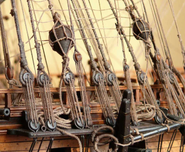

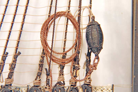

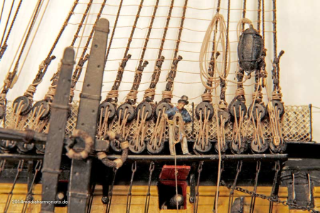

One detail on some contemporary models, usually French, that always leaves me scratching my head is the placement of anchor trip line coils and their buoys stowed hanging high in the foremast shrouds. This seems to have now become a somewhat mandatory detail of the the "cannons and gingerbread" kit genre. Some versions even have more than one depicted. Often, the trip lines are ridiculously short, or lightweight, given the anchors on the model. Sometimes the buoys are hung half way up ther lower shrouds. The size of some of these buoys would require two or more stout fellows just to horse them around on deck, yet somebody thinks these ships sailed around with such equipment routinely stowed in the rigging! Who would ever think climbing half way up the ratlines to stow a thing like that makes any sense whatsoever? Who hangs ground tackle in the rigging? This stuff belongs stowed on deck or below. It's only used when anchoring anyway. Mind you, I haven't done any specific research on the issue, but I strongly suspect some long gone museum curator came across an anchor buoy that came adrift from a model and thought, "Where the hell does this thing belong? Well, this looks like as good a place as any." and so tied it up on the shroud and from then on thus ever was it so.
If anybody has a better explanation, I'd love to hear it.
This "double header" is my favorite. The trip lines is just stuffed behind the lower deadeyes. Hardly shipshape on a naval vessel.
If this length of line were sufficient, the ship would be aground at low tide, and, God forbid, if she took the ground on top of her anchor, it'd punch a hole in her bottom for sure.
Does anybody really think that a trip line of this size is going to be sufficient to break free either of the anchors next to it?

Regarding the error by the design of the sailing boat :
A 2.block can be attached to the yard and hull opposite to the existing block similar to genova system to make this existing model functional

The designer of the above longboat who apparently was not a sailor, did make an honest mistake in locating the mainsheet traveler. When he decided to produce a larger scale longboat model kit, he repeated the mistake despite knowing that it was wrong.
Roger
