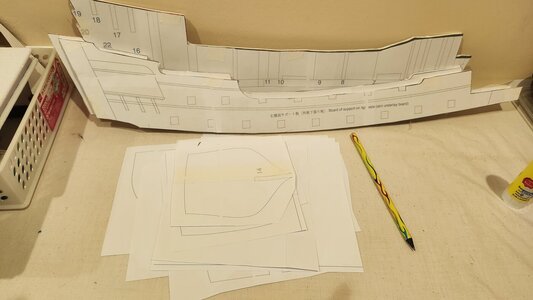

Sorry for my delay. I have had endless issues trying to resize it. I suppose that was being a little too adventurous on my part. So l decided to play it safe and stickk with the dimensions of the original plan. It prints out to exactly 57cm for the keel. I have Windows 10 and l just printed it normally, but on A4. I had tried several ways to do this with various software, but the only thing that worked was Adobe Reader, free version. You convert the image into a PDF file, click poster, greyscale, and print. It prints the whole pic (each image needs to be printed separately) onto 8-13 A4 pages, depending on the size of the image. The setback is that you have to piece some sections together like a jigsaw puzzle, but the scale remains exactly the same. I have already pieced it together and got started. I know there will be bumps along the way but l will try my best to push through. Let me show you what I've done so far. I am not done with the cutting of these pieces yet. I will have to adjust the grooves depending on the width of the material l use.
