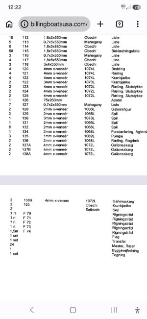

Hi Noël
According to one of our hobby dealers in Sweden, it looks like this:
F70 = Ø 0,2mm
F71 = Ø 0,5mm
F72 = Ø 0,8mm
F73 = Ø 1,2mm
F74 = Ø 2,0mm
// Krister

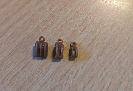

Hi again Noël
I checked a bit deeper and I think it's a misprint in the manual. As you say there is only one item F64/1 in the part list and when I count the ones I have, it's about 180 plus pcs.
I think the one that is mentioned as F64/2 should be F223 instead.
Look at the picture below: From left to right I believe it is F223, F222 and F64/1

Hey Krister_L, I think you're right! F64/1 is a 5mm block; a double 5mm block cannot be found in the kit! Looking at the drawing, it seems to be a double block. L8 has 2 lines running from Ra no. 2 on page 28 of the manual through the double block to the deck. So, two lines. The only double blocks in the kit are F223!
Thanks for helping look for a solution!!!

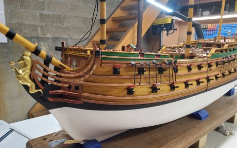

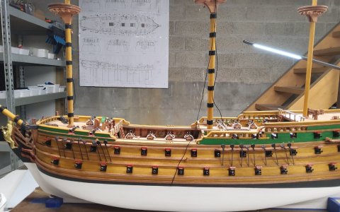

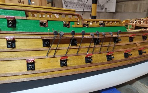

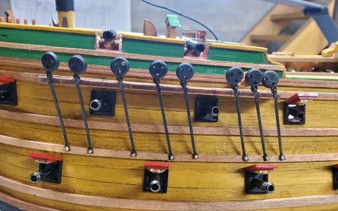

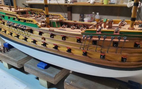

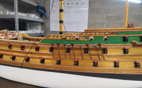

Hello everyone! After my surgery, I started preparing the rigging. I began by painting a number of deadyes black. Next, I placed the copper connections from the deadyes to the hull in acid to blacken them as well, and then I varnished them!
After that, I mounted everything for the forward and middle masts on both sides of the ship. It turned out better than expected and already gives the boat a bit more character. (See photos)
