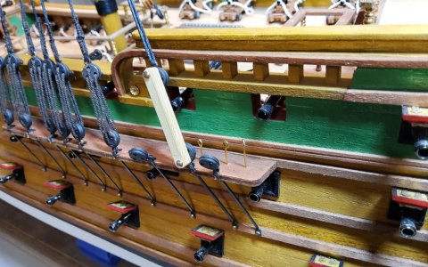

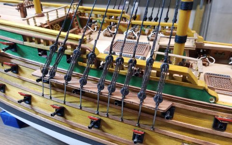

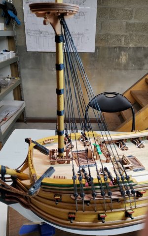

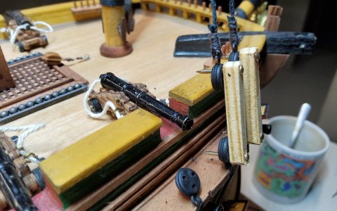

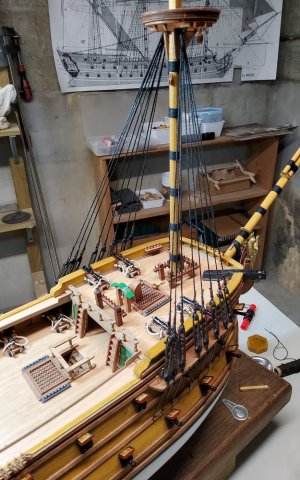

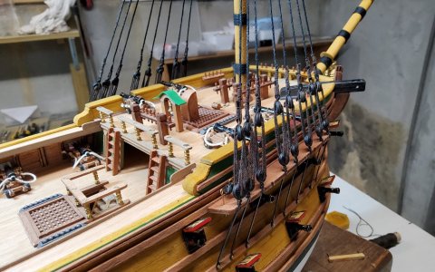

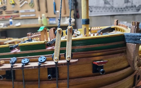

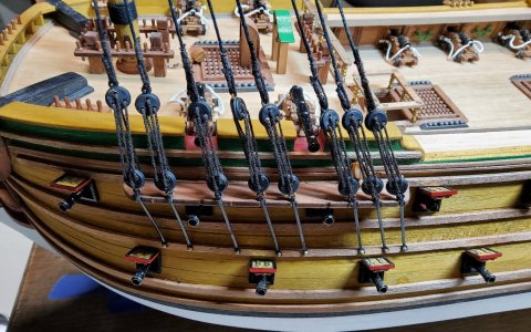

Hello everyone! After my surgery, I started preparing the rigging. I began by painting a number of deadyes black. Next, I placed the copper connections from the deadyes to the hull in acid to blacken them as well, and then I varnished them!
After that, I mounted everything for the forward and middle masts on both sides of the ship. It turned out better than expected and already gives the boat a bit more character. (See photos)

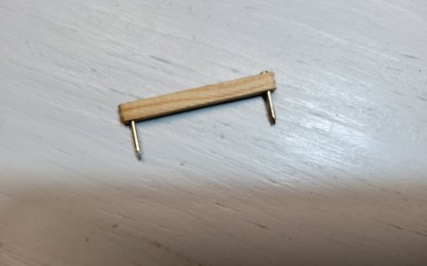

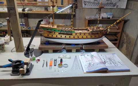

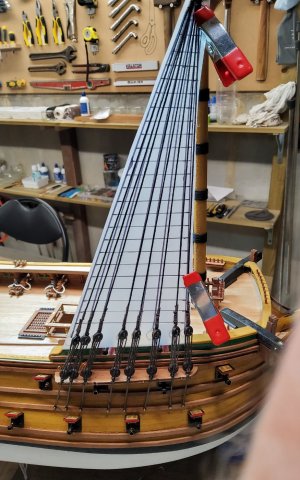

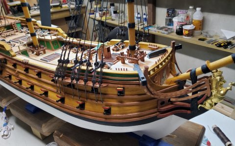

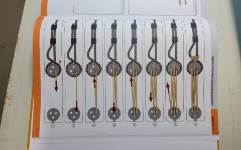

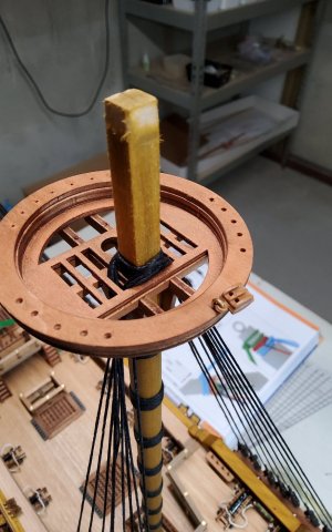

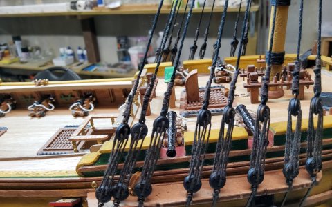

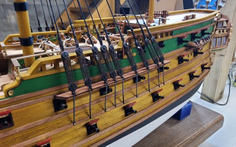

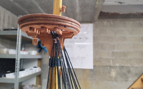

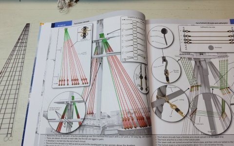

Hello everyone, the next step is rigging the ship! First, I bought three books on rigging and spent quite a few hours on the internet trying to understand most of the English terminology. I had never heard of many of the English terms (my first boat)! In the meantime, I have learned quite a bit; I hope enough to get started. The first photo shows everything I used to start mounting the shrouds. I used 1.2 mm black rope. I painted the deadeyes black. I also used a jig to ensure that the deadeyes are all spaced the same distance apart. For the laniards, I used 0.5 mm brown rope. Only the bottom shrouds of the forward and middle masts are mounted now. For the first time, I think it looks reasonably good.
The next step is the shrouds of the mizzen mast and then the ratlines. Best regards to you all!
