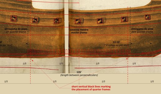

In this excerpt from Fernandes' description, which you quote above, in my opinion, the division into five does not refer to the number of components of the entire master frame template set, but to the dividing of the hull length for the allocation of numbered frames, for at least three reasons:
— first, three templates are sufficient rather than five in the geometric arrangement of the master frame of the patacho. This naturally refers to one side of the hull (it is unlikely that two sets were used separately for both sides of the hull, as this would have made it even more difficult to maintain the much-desired symmetry). So, apart from a possible template for bottom/hollowing curves applied later, these would be moulds for cavernas, braços, and hastes (floor timbers, futtocks, and toptimbers, respectively), partially overlapping each other. Admittedly, there are also aposturas (2nd futtocks), but here they are essentially of the same curvatures as braços and hastes,
— secondly, if we assume that this division into five would nevertheless refer to the number of components of the frames template entire set, and not to the division of the keel into five parts, then the next passage, i.e. “nas duas porao a madeira” (or, in English, “in the two the frames will be set”), would remain without context and meaning,
— thirdly, finally, analyzing this draught graphically, I found that the markings made by Fernades, indicating the placement of both quarter frames, are located quite precisely in accordance with the division of the hull into five parts, as shown in the graphic below:

As for the length of the ‘deadflat’ measured by the number of frames, fortunately this feature does not require some vague interpretation, as it is made quite clear or confirmed by another, yet unquoted passage from Fernandes' text:
[...] quando quizerem embaraçar the madeira de conto no chao [...] & isto se entende na almogama de proa vir multiplicando da caverna mestra a tee a almogama [...] repartindo em partes que sao quinze pontos tirados na mea lua [...]’ (in English: ‘when one wants to join the [parts of the] numbered frames [still] on the floor […] this is to be understood in the direction of the fore quarter frame, by multiplying [i.e. rising and narrowing] from the master frame to the quarter frame […] according to the fifteen divisions obtained by the mea lua [...]’).
In other words, the shape transformation is applied to the last fifteen frames out of sixteen on this side of the master frame. As a result, it follows that three frames remain for the ‘deadflat’, i.e. the master frame and one adjacent frame on each side.
