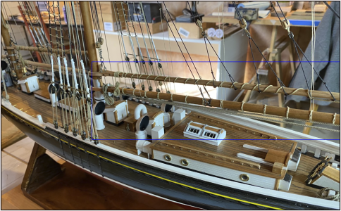

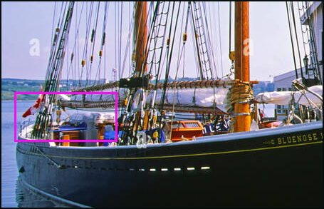

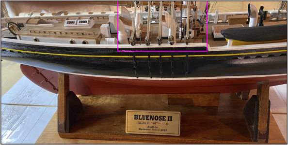

At 1st I have 2 question about your model, shown in your pictures:
1: Why did you make the lanyards between the deadeyes so long that the upper deadeyes rise above the main boom?
On the BN-II in the harbor of Nova Scotia those deadeyes are much lower:
2: Why have you 'over-dimensioned' 'some' ropes? For instance on the Main Boom and Gaff:
Fore a 'commissioned' model I would have asked this question.
