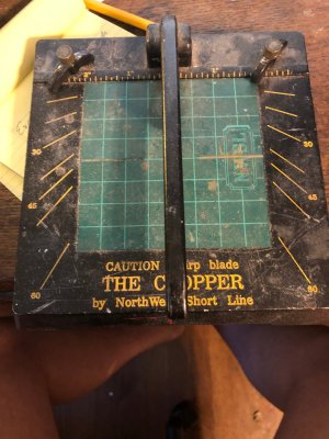

Have you considered a "Chopper" by Northwest Short Line." NWSL is mainly a model railroad company but it had some good items. I have two of these, the original which is about 6" x 6" and the "Chopper II" which is approx. 4" x 12". Both have hold downs on either side of the chopping handle and each has two flat pieces mitered to provide 30, 45, 60 and 90 degree stops. The hold-downs are very good, never had a problem with them. The "knife" uses replaceable single-edge razor blades. I have used these for years and have found them pretty much indispensable for cutting items to length or to get an angle for mitre joints. I am sure I got the Chopper II from Micro Mark and probably got the Chopper "1" from MM as well. MM Has an on -line catalogue and it ships orders very promptly. MM also carries an abundance of tools and othe items for modelers of all types.
