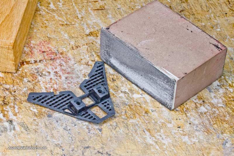

The result was 3 separate parts: Barrel, fork and holder, the rear support of the fork is 0.2 mm thick.
And you can see that it is actually fully movable, laterally and in height. Here the printing of the resin is no longer the threshold to the event horizon, but actually the pressure on the builder and his breathing to shear the 0.3 mm trunnions into the eyes of the fork.

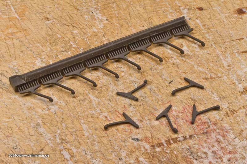

For a simpler assembly I have simply rethought. I already detached the trunnions from the barrel of the Constitution guns and printed them on the gun carriage. In this way I was able to represent the flaps at any elevation angle of the barrel and without the classic gap at the top. The tube then had the mount on the underside where the trunnions were: beautiful, practical and invisible :-)
I used the same method here. The trunnions are integrated into the fork, stabalizing it while printing and especially during washing, and the mount was recessed under the tube. Now only 3 rounds of test prints were necessary until the necessary tolerance/clearance under the tube was found so that the mount works easily and yet with good guidance. Painting is done with the fork mounted, otherwise it will no longer fit. The test assembly was then possible without any losses within a few moments and, above all, in a very relaxed manner :-)
And here's the whole kit: the printling in its housing, which ensures that no small parts get stuck to the base plate during printing, as the superstructure "collects" them. It also serves as protection during washing and shipping.
And on the left, the individual parts and the assembled piece. Visually, the assembled parts do not differ from the previous models, but they are much more precisely aligned and thus appear tidier.
