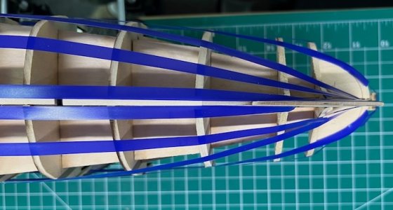

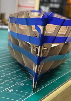

I spent time over the past 3 days fairing Harriet's hull. I first used thin black artist tape (used to make lines on white boards) to make sure the bulkheads were all aligned. It showed I needed to shim Bulkheads 5 and 7 on the port side, and 9 on the starboard side. I glued on 1/32 x 1/8 shims and let them dry overnight. The 5 and 9 shims only needed to go to the horizontal piece A, but 7 had to go to around the curve of the bilge.

I used the artist tape to check on my progress after I thought it looked good. I find the tape makes it easier to detect areas that need more refinement, compared to sliding a planking strip along the bulkheads.
I mark areas that needed more work with a pencil:
The only issue with the artist tape is that it isn't very sticky. But you can reuse it to recheck your progress by just holding it against the bulkheads. When I thought I had a fair hull I used 3M masking tape for a final check. Of course you can't assess the very stern because the stern counter isn't installed.
It looks good to me. I will let it marinate overnight and re-assess it in the morning to see if I still am still happy with it, but I think I will be. Overall, I found it easier to fair this hull compared to my last build, the Model Shipways Lobster Smack. The larger size and shape of the hull meant less and more gradual curves.
