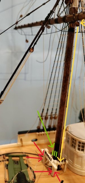

I submit the yellow and green lines (not the DC subway lines) are either/or, you don't need both. Preventer-stays are mostly a warship thing, something to back-up the main part in case of battle damage.
She was refit, ending up in the configuration you're modeling, at a Navy depot, so she may have been rigged Navy-style, but if they didn't need to make extensive repairs to her rig, they most likely just put it back to rights as it was, which was more merchant ship than warship, considering her designer/builder.
The green line (fore-stay) allows for a more substantial sail than the yellow line does, and if done Navy-style, would have been doubled, side-by-side. un-snaked, so a heads'l could be hanked on.

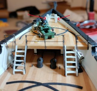

If I were to do it again, I would add cleats to the sides of the bitts for the jib stay in and outhaul lines. See red arrows in pic below.

For the foremast bitts, I should have done the same thing. Part of the problem was having the bitts close enough to the mast so that the bitts didn't seem to intrude into the space for the gun. So, with the spatial relationships in mind, I did not make the bitts wider or longer so accommodate more belaying pins and ease of belaying the lines for that matter. Not having enough space for pins the necessary pins, cleats the port and starboard and on the forward side of the bitts would have been useful for belaying the lines from the upper ends of the running rigging for the jib stay and foremast stay and the sheets. Red arrows for additional cleats. Yellow arrow for the track of the sheets. Another solution would have been the addition of cleats to the mast. Cleats on the aft side of the mast would have been nearly impossible to rig (IMHO), BUT at least 270 degrees of the mast from a point on the port side to an identical point on the starboard side could have been used for cleats and spared the use of the belaying pins so that no line shared a pin with another line. See green notations and arrow.
