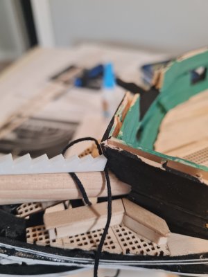

I sort of put together a rough idea together about how to do the gammoning. It will be ropes and I was thinking I would make a small notch under the stairs so that the gammoning can go around the bowsprit. The following photo shows about where I would notch out the steps.
PS No heads in my build. They are benches. I will say no more on this subject.

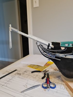

I went ahead and completed part of the bowSprit so that I could do the gammoning before closing up the bow. I thought it would be easier to add the gammoning with the bow still opened. In a perfect world, I would have added two sets of gammoning but I couldn't because the bow is partially built. I should have thought about this earlier in the assembly process.
If this was lifesize, you couldn't pay me enough to try and climb the rickety old stairs that I made on top of the bowsprit. lol.
