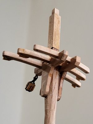

I have to decide whether to make the topmast crosstrees out of wood or 3d print. The problem is the type of wood I have is bass wood. I have made those crosstreas in the past and they were a pain because of the wood. THey would break on me all the time and when I went to drill the little holes at the ends it would break the crosstree. Maybe I can source boxwood from somewhere around here...
Hi Jack
I used the Bass wood provided with the kit and brushed on some thin super glue to reinforce the timber before drilling.
Tony

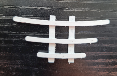

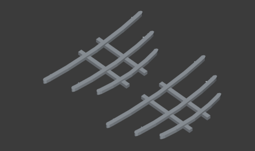

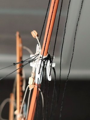

In the interest of doing something while I wait for my wood, I decided to create a an stl file for the topmast top. I'll add the cleats after. I want to use the cleats that are used on the deck. I don't like the cleat design on the plans. I'll drill the holes myself. Other than that I think it has all the required elements
They look great. Just make sure the masts fit the openings when you make them.
Thanks
it took me a long time to get that to work. It was the hardest part because of the dimensions and keeping things proportional. ie change one thing and it changes the size of the holes...
Oops, I think you overlooked something. I'm not talking about the holes, which you can clearly drill. What about the chocks at the ends? You're going to print it in 3d, I would suggest adding those. What's the point of making the chocks and then gluing them on.
