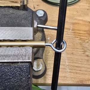

I drilled a hole in the brass rod just in a slightly smaller diameter than the OD of the thread at the end of the hook. I screwed the thread at the end of the hook into the brass rod, and was able to cut a thin thread, in effect using the hook itself as an ersatz tap. To secure the hook completely, I slathered epoxy on the hook's screw thread and drove it home into the brass rod. The thread itself was pretty tight to begin with; the epoxy is perhaps overkill, but I feel confident this is going to stand up under hard use.
I want to emphasize that these are just proofs of concept. I will turn the 6 mm diameter brass rod in the correct lengths to pass through the bushings in the plywood panels and the spur gears.

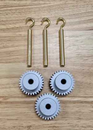

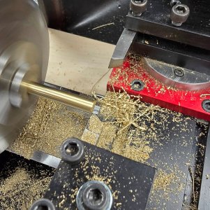

I took another day off from rigging and booked a little more time on the Rope walk.

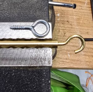

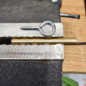

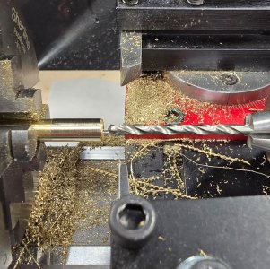

I'm still waiting on the flange bushings, but I finished the shafts with the hooks. I got the same thread on Steel screw eyes that I had on the brass cup hooks and used those steel screw eyes as the taps. It was still touch and go, but I managed to get the threads cut and they're nice and snug. I probably don't even need the epoxy, but I will glue them in after I've cut the shafts to their final lengths.
For this particular size cup hook screw, I had to experiment with drills before I found the correct size. In this case it was a number 34 drill, 0.1110 inches or 2.82 mm.
