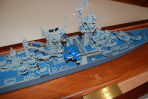

It's easy to go crazy over the grays and the blues used on WW2 ships. To add to the load of trying to achieve authenticity, the colors are effected by the weather conditions that your model was operating in and what camouflage was being used in what theater of operations.
Just a suggestion, pick what looks good to you and enjoy. After all, it's your model.DSC_0107.JPG
