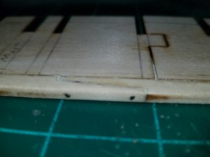

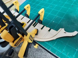

First up is removing and gluing together the two parts of the center keel from the plywood sheet. Not only should you clamp the two pieces together for several hours (using carpenter's glue) before touching the completed piece, but you should also either weigh down the assembly or clamp to your work space the whole thing. This will keep the piece straight and prevent warping. Before installing the bulkheads you should wait 24 hours but a few hours is all you need to start with the the stem, keel (two pieces), and stern post. These pics show the stem and the first of two keel sections glued up and clamped. Next I'll install the second keel before going to bed tonight and the stern post tomorrow before work. I can already see that wood filler will be necessary to smooth out the transition from center keel section to keel will be needed. No worries though, all that will be covered up by the copper plates to be applied later. All that's needed is smoothness.

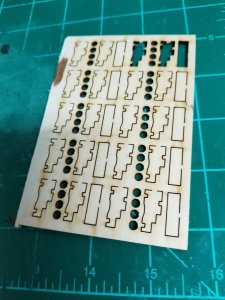

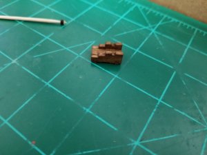

In my opinion it's quite acceptable to jump ahead with some time consuming tasks while waiting for glue to dry. To have that center keel assembly with keel and stem and stern post really ready to start accepting bulkheads you should wait a minimum of 24 hours. Well, I can't wait here just watching TV so I'm jumping ahead with making the gun carriages. With this kit 8 guns are displayed and so 8 gun carriages must be constructed, but the option to display at least the barrel of a cannon in some of the other gun ports exists. My plan is to complete 10 guns as planned where they'll be fully rigged and then purchase some of those cannon stubs that stick out in gun ports below decks like on HMS Victory. This kit has 12 of the gun ports just closed up but I like the effect of keeping some of those ports open with a gun barrel sticking out. Another note, the supplied gun port covers are britannia metal and I just don't like having to paint them black, it just doesn't look realistic at all. I plan on scratch building all the gun port covers. Pics are of one test of a completed gun carriage, I'm using "Historic Ships" brand walnut stain for the carriages and wheels. The wheels themselves I painted black on the outside of the wheel to simulate the iron banding of such wheels but I like the effect of keeping the inside of the wheel the same walnut color. It's a lot more labor but not boring.

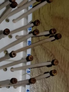

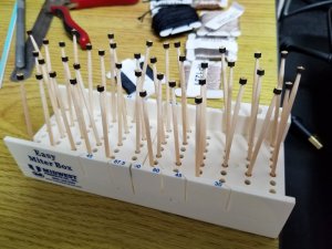

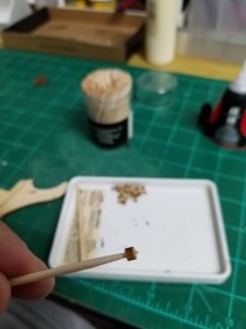

The black for the iron banding of the wheel has dried so I stained the wheel hub with Historic Ships walnut stain. The small scale looks a little goofy but with the un-aided eye it looks pretty good.

Center keel assembly now has the stern post, keel, and bow stem attached. I filled in all the joints with wood filler and sanded it smooth. All that will be covered by copper sheathing so it just has to be smooth. I also sunk nails every four inches or so. I once had the entire keel assembly break right off my Syren when clamped into a planking vice, won't happen this time.

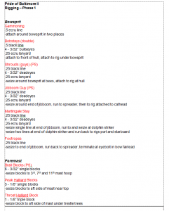

The Mamoli rigging instructions and plans are very specific and easy to follow, which is quite unlike the MS instructions and plans, as you have observed. I can tell from your picture that the plans for the Rattlesnake are of the same style as those for all of the MS kits I've worked on. I'm now studying the plans for my upcoming fifth MS kit (Pride of Baltimore II) and I can assure you that, as dense as they are, they are actually quite comprehensive and can be deciphered; it just takes a lot of work.
The first thing I do with them is take them to Staples and make copies. Then I can mark them up all I want, make notes on them, highlight things etc. without ruining the original set. Also, when they're printed on both sides, it's a lot easier to have separate sheets for each one.
With the rigging plans, I go over them many times and make notes. Eventually after several iterations, I distill my notes and create a set of detailed instructions for myself. I divide the process into two phases - the first is rigging the bowsprit and everything that can be attached to the other masts while still on the bench and the second phases is everything that can only be done once the masts are mounted. Here's a sample page for my upcoming Pride of Baltimore II.
It is amazing how much information MS crams onto those pages. It takes a lot of detective work to make sense of it all, and you have to jump all over the plans to put all the pieces together, referring to the inset details etc. (remember that they're usually at double the scale. I once finished a set of trestletrees and crosstrees that were twice the size I needed before I noticed!) After about two MS kits with this style of plans, you'll develop a feel for them and find them not too difficult to work with.
Another advantage to pouring over the plans several times well in advance is the frustrating fact that you will find things in there that are not included in the kit. For example, so far I have discovered that the POB II calls for 3/32" bullseyes, a couple of triple blocks, turnbuckles and many thimbles (small bullseyes). None of these is included in the kit. It takes several times pouring over the plans before I find everything, so I develop a list of the missing things and try to get it as complete as possible before placing an order.
