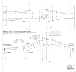

Hi , just for information, the original of the shaft hole plus the wedge housing are historically real. Frank
I respectfully disagree. While I cannot speak with authority about other Viking long ships, I can, with a fair amount of certainty, say that there was no wedge in Oseberg. Neither Dr. Bischoff's drawings of the original, nor the photo shows a wedge. The long removable cap on the aft portion of the mast partner reveals a long slot into which the mast could be lowered.
Your image only refers to the Viking Museum in Oslo (in Italian). That is where Oseberg is located. You've shown nothing else. I have already stated that I cannot speak to other Viking long ships - only Oseberg and Oseberg had no wedge at the mast. What would it wedge against? The loose and removable cap on the mast partner is meant to allow the mast to pivot aft for lowering or repair. You cannot wedge against a loose member. Once the forestays were loosed and the cap lifted, the mast would pivot aft within the slot of the mast partner.

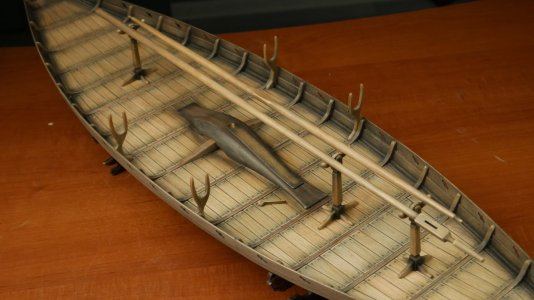

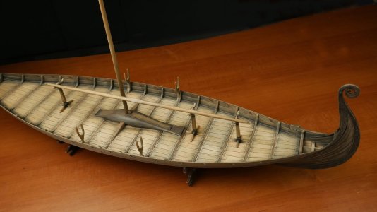

The mast and rai are ready. It took 84 minutes to make these elements from what is in the kit: mast - 48 minutes, rai - 36 minutes. For this work only hand tools were used, which are on the photo.
What is that short rectangular piece on the left side of your picture with the tools? It’s in the kit, but I have no idea where it goes or if it needs to be rounded.
This is the mast part, it has a spike and the mast has a groove, they need to be glued together, it's in the instructions. It's just that the mast is too long to fit all the way into the box, so I had to do it this way....

From an historical perspective, it's just wrong. There was no evidence of a wedge to hold the mast in place. According to Dr. Bischoff's drawings of the keelson, the mast step socket appeared to have a square cross section which would have prevented the mast from rotating. The mast partner (the large hump that spans four frames), was slotted from the mast hole aft to allow the mast to be tilted back for maintenance. The mast partner cover sat loose over that slot. The mast was held tight against the front of the mast partner by the forestays, the deep socket in the keelson preventing the foot of the mast from popping out. No wedges were ever used.
Additionally, (sorry JBB, I know you've already made your mast) the forward face of the mast was left flat. In other words, when the square beam was turned first into an octagon, then rounded off, the forward 1/8th face was left flat, for additional strength it is assumed. Unfortunately, we don't know if, or how far up this flat was preserved, since the top half of the original mast had rotted away.

I've been working on this model for a month or two, there are some quirks along the way but so far I think it's turning out pretty well. I decided to follow RussF as far as moving the mast forward one frame forward to be more historically correct, it's a lot of planning and figuring out out how to do it...but in the end I think it's worth it.
