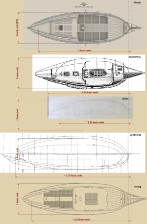

Now totally off the cuff - when you view De Zwane (refer the first illustration of your latest post), the overriding impression is of a very wide, bulbous hull which is very short in overall length. Even though the rendering is of De Zwane and not of Barentsz's ship, it does make for a fascinating comparison between the two. The interpretation is unlike the narrower hulls of Hoving and De Weerdt, but far more in line with the way that the Russian experts rendered the ship.
Model-builder Zhdan.
Right, taking into account the original contractual proportions, the Russian interpretations do indeed seem to capture the visual character of the vlieboots or Barents’ polar expedition ship more convincingly than the reconstructions produced by the Dutch themselves — that is, by the country of origin of these vessels. Nevertheless, partly out of my own curiosity, I have examined the specific numerical values of the most basic hull proportions in the reconstructions to date (specifically, the breadth-to-length ratio), and the results of this comparison with the parameters taken from the relevant construction contracts of those years are, it must be said, quite intriguing.
Be that as it may, these are definitely not the sort of things that can be corrected even through the most thorough ‘bashing the kit’ — beyond unbelievable boundaries, one might say — a practice particularly popular amongst model-makers, because, unfortunately, it seems that no amount of ornamentation nor even the most elegant-looking blocks will be able to save the day :).

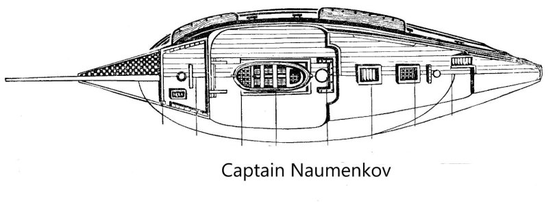

Perhaps a few more words on the diagram above and this particular proportion used in reconstructions to date is in order.
It is perhaps fair to say that Naumenkov’s and Hoving’s reconstructions are, in this particular respect, relatively close to the contracts for the construction of vlieboots from the last decade of the 16th century, as they were based either on real contracts from around the same period, or on archaeological remains, or both.
De Weerdt’s reconstruction, I believe, is also based on source accounts, but primarily those of a general nature and dating from several decades later, when the ships being built were already relatively longer.
The more or less successful interpretation of these sources remains, as it were, a separate issue.
Zhdan’s ‘reconstruction’ should, in fact, not be taken into account at all, as it is well known that this model-maker deliberately distorts even the most fundamental features of ships in order to achieve his intended artistic aims, which take precedence for him.
