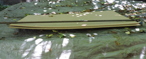

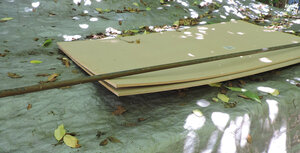

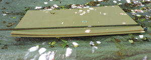

Does Mdf warp like plywood? If not it would make a great choice for keels and bulkheads.
I was in the shop yesterday I found these 2 pieces of MDF board. What I do is lay them flat with a weight on top to prevent them from warping. these 2 sheets were sitting by themselves. Once this stuff warps you can not unwarp it because they are effected by humidity. Plywood you can wet it and use weight to straighten it out, you can not do that with MDF board.
The pipe is straight so you can judge the amount of warp.
Personally i would not use this stuff for structural parts in a kit.
