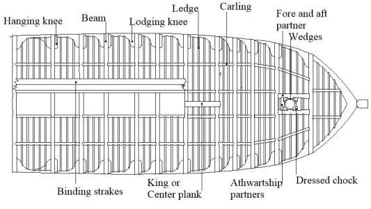

Why aren’t the spikes shown on every board across every deck joist?

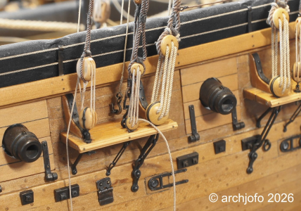

For the sake of thoroughness, though, it should be acknowledged that there is a certain artistic ship model presentation style that doe reveal real functioning treenails properly placed as they would occur on the prototype. This is because these models are presented without opaque finishing (e.g., paint) in order to depict that actual construction details of the prototype vessel. Contrasting colors, such as they may be, are depicted by the use of differently appearing wood species, all of the highest quality. This "clear finished" presentation may show actual treenails as slightly darker than the planking species because locust, the preferred species for treenails, was slightly darker than the planking species. In this instance, this is an accurate portrayal of the prototype vessel and does not detract from such models' effectiveness. When encountered, the color contrast will be seen as rather subtle.
There are currently some modelers, notably in Belgium and France, who particularly favor this sort of presentation and have given it a bit of a renaissance. Properly done, the style can be very attractive. It absolutely requires total fidelity to historical accuracy and only the very highest level of craft skills. At present, I would expect no more than a half-dozen of such models are produced each year. I know of no kits available for building such "as built" models. It is truly "modeling without a net" because it is a style that demands the highest level of quality of its builder and is ruthlessly unforgiving. See: https://shipsofscale.com/sosforums/...-by-archjofo-scale-1-48-french-corvette.7643/

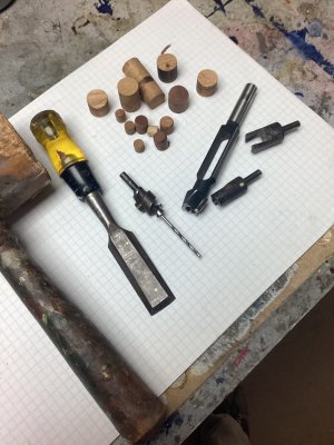

The photo below shows a collection of wooden plugs, and the tools that go with them. The last wooden boat that my father and I were involved was a Thistle Class sailboat built from a moulded mahogany hull. We built all of the internal structure and fitted it into the hull. The centerboard trunk sides were two mahogany pieces about 5ft long x 3ft wide. The project involved 100’s of plugged wood screws. At that time plugs could be purchased and we had a whole bag of them. I believe that the drill with the spiral shell in the photo is the Fuller countersink that Bob Cleek mentions. It originally had a much shorter drill bit. The long 1/8” bit shown is just for demonstration. The three items at the. Lower right hand corner are cutters for making plugs with a drill press.
In thinking about Signet’s post #14 above it occurred to me that there’s a major advantage to use plugs instead of treenails to plug deck planking fasteners. Can anyone tell me what it is?
Hint: look at tools below.
Note: Bob Cleek doesn’t get to answer (He probably already knows it)!
