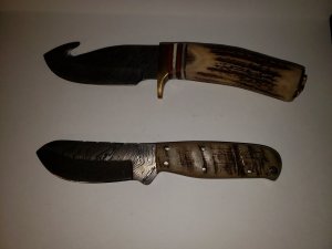

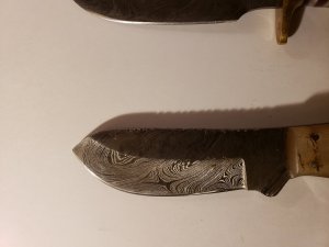

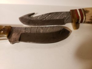

I made a set of hunting knives 3 years ago and they have held up far better then any store bough knife I have ever owned. The top Knife with the gut hook has a deer antler handle the skinner has a stag antler handle. That gut hook was difficult to get right to much angle or to little and the knife doesn't work as it should and will keep popping out of the hide or it can dig in and pinch the gut opened. I keep them coated on Peanut oil which works well for preserving the metal and the scent doesn't spook game.
Great looking knives, not to mention awesome craftsmanship, Joe. I love how Damascus steel looks...it just beauty of it's kind.
