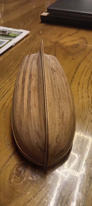

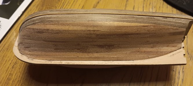

That means the lower part of the second layer is now finished too.
It consists of 4mm mahogany, which, like the walnut above it, came in beautifully cut strips.
These were actually a little warped, but that turned out to be an advantage in the end.
This meant that, just like with the walnut strips, I didn’t have to soak them in water and bend them.
Next, I’ll be cladding the keel before putting the finishing touches to it.
Have a lovely Sunday, everyone
Translated with DeepL.com (free version)

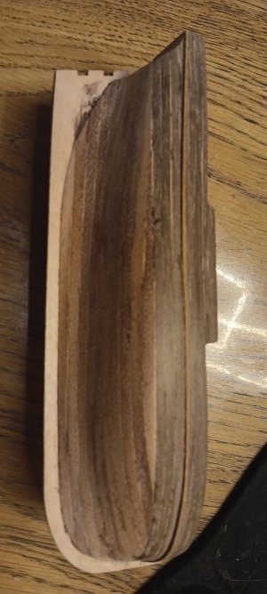

Hello everyone,
So, the hull and the keel are now finished and sanded down.
As you can see, I’ve also fitted the windows and the transom.
I’d actually intended to make both of these myself, just like the door. But in the end, I decided to go with the original parts from Mamoli.
I had a cycling accident last week, which means I can’t go to work at the moment. A Rottweiler thought it had to jump into my side.
That’s obviously coming in handy for the boat-building.
Next, I’ll probably fit the rudder before moving on to the deck planking.
Take care and don’t let anyone push you off your bike.
Hello everyone,

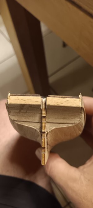

Hello everyone,
Yesterday I planked the bow and aft deck. As you can see, the transom has come loose again.
Well, I was clever enough to varnish the bonding surface before fitting it.
But that’s just as well – I wasn’t too keen on the way it looked. The rudder didn’t quite fit properly either. So I quickly planked the back of the transom with 1mm-thick walnut and created space for it by sanding out a recess.
Cheers
