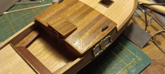

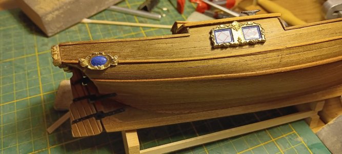

Today I focused on the cabin roof. I fitted the door cover and carefully sanded, waxed and polished the roof.
I also ended up treating the lower part of the hull with antique wax after all. The leather grease had ended up looking a bit too dull for my liking.

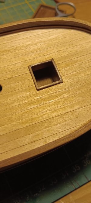

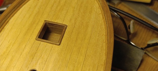

I’ve covered the deck hatch on the foredeck, along with the frame underneath, with 1mm walnut.
I still need to fit a ladder there. I’m not sure yet whether I’ll make a hatch – the plans don’t include one. But it would actually make sense.
Plus a bit of bling at the stern.
