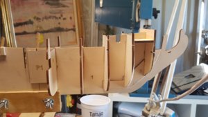

Having following Epicdoom's build of the Pearl with great interest I've decided to post a Build Log of the same Ship, although I have found that kit I have is an updated version, two things I've found different is 1. The cabin door facia becomes the front wall of the cabin ie no bulkhead behind it. 2. The hidden gun ports line up to bulkheads properly that is not half way or slightly obscure of the bulkhead. As with Joes build thus far parts have fitted perfectly with minimum adjustment too no adjust needed, also the instruction manual is a little vague in parts but is easy to figure out with knowledge of my first build of HMS Jalouse so it would be confusing for a first time builder tackling this kit, some of the grammar and English words used are a little tricky.

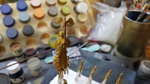

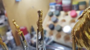

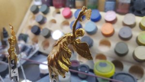

So I will post some photos of my progress thus far up to : Keel layer down, Bulkheads install,LED wiring and lights in place,and some painting of ornamental figures,pre build of Captain cabin walls,windows etc.

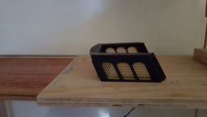

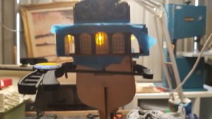

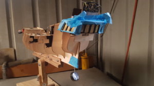

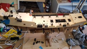

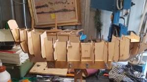

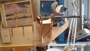

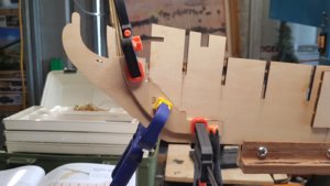

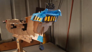

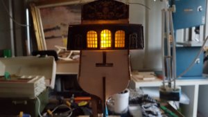

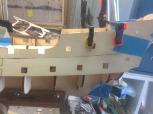

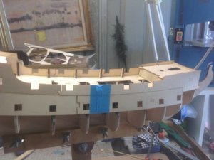

Ok fellow builders her is a few pics of build so far excuse the photo with the blue tape I was working out where the LED would enter the Cabin I've put them as close to the roof as I dare. Sorry about the upside-down pics I will adjust that with the next lot of pics. As you can see the bulkheads don't interfere with the gun ports like Joes did. Pictures with Bulwarks in place are dry fit at this stage, the false deck has been glued and the front wall of the Captain's cabin. The wiring of the LED's was placed through the bulwarks to the cabin cavity the side cavity of the cabin the wires come through the bulwarks below roof level, also one out of the stern plate to illuminated the rear windows, I drilled down into the stern plate the as Joe and that was scary had a little mishap but its amazing what putty and paint will hide. The Switch/battery holder that came with the as did the LED's the wires from it run down the keel stem close to the hull but hidden in grooves that I carefully dremelled so they sit flush planks will hide them, hope I never have to redo LED's if they blow. So its Beer o'clock here downunder till next post cheers.20191202_162528.jpg20191206_150917.jpg20191206_164343.jpg20191207_165805.jpg20191207_165829.jpg20191208_175716.jpg20191208_175723.jpg20191208_175741.jpg20191208_175801.jpg20191210_085809.jpg20191210_085816.jpg20191210_085836.jpg20191213_163647.jpg20191213_163654.jpg20191213_163702.jpg20191214_165907.jpg20191214_165917.jpg

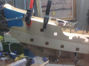

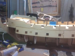

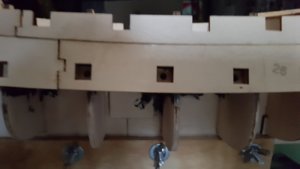

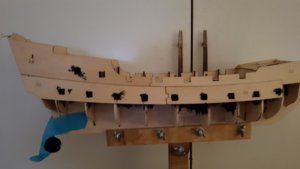

Bulwarks in place after multi dry fitting and some fairing done on bulkheads on the starboard side. I have a good friend whom is a master builder who has given me heaps of encouragement and his knowledge on how to go about ship building, Because of my past blinds of assembling plastic models and speed of which I have completed them he has urged me to slow my build rate down with ship building, this is not easy for me to adhere to with a lot of time up my
sleeve ie I'm retired this build I will try to slow the @#%& down lol.

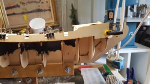

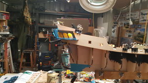

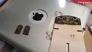

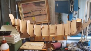

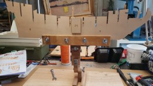

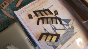

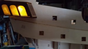

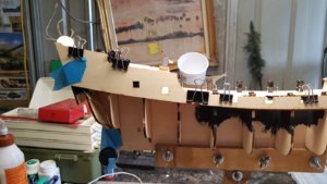

Anyway a few pics to bring the build up to date basically bulwarks glued in place cannon supports also and painted, some bevelling to starboard side bulkheads. Dry fit of cabin windows and painted LRD light up inside nicely although the camera makes them appear brighter than they actually are I'm happy with them. Its rather hot here the past few days so not getting much progress but that's a good thing it slows my pace down.20191216_203022.jpg20191216_203035.jpg20191216_203040.jpg20191220_172943.jpg20191220_172950.jpg
