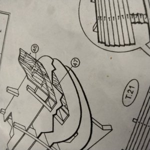

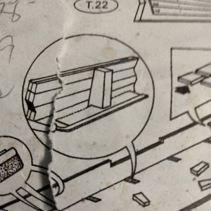

I need some help from someone who has built this kit. Detail T.22 on sheet Plan 2 shows the outer portion of the deck double planked outside the stanchions. How far down does this planking go.
My second question is part 47 at the stern. Should I add the windows etc to the part prior to gluing it in place.

Hi Ted, got to tell you, planking the decks prior to installation is a great idea. I planked mine after install and had to resort to tweezers to lay the planks under the 2nd and 3rd decks. Not ideal.
As for your questions:
I double planked down to the top of each deck and no further.
As for the aft windows, I installed them after finishing planking, otherwise I would have had to cut many small pieces of veneer to fit around and in between them.
