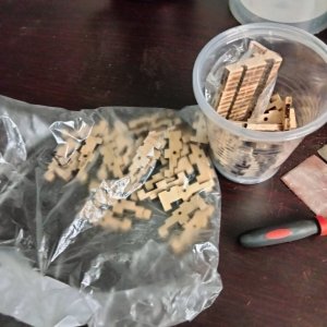

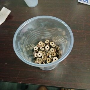

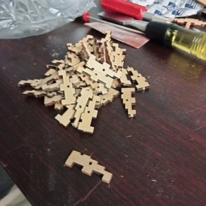

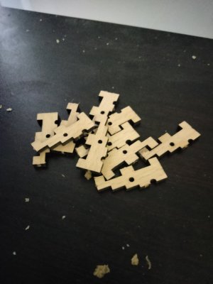

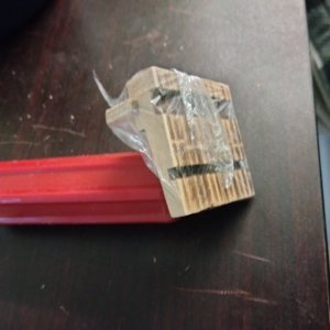

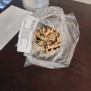

I finished sanding the cannon carriIMG20251206074139.jpgIMG20251206074135.jpgages for the cannons with only two wheels and started my little bag full of the four wheel carriages. As for the rigging I'm going to do it like the Santissima Trinidad.

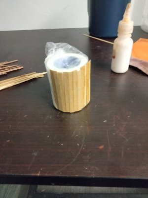

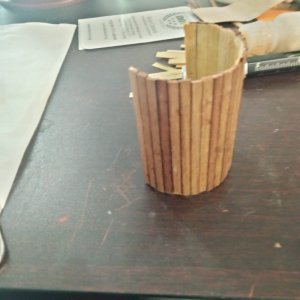

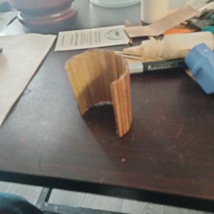

The circular stairs have a wood wall surrounding the openings. The plans show this as being a sandwich of 0.5x2mm with 0.5 x3mm. The parts list doesn't indicate any wood of this thickness. In using 0.33 x 4mm and 1x3mm wood. I surrounded a spool of paper surgical tape with saran wrap and glued in the 0.33 layer first.17653442378962111863233682714501.jpg

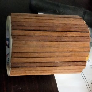

Here's he second layer applied directly on top of the one shown above. I think this is going to be too fragile to be workable

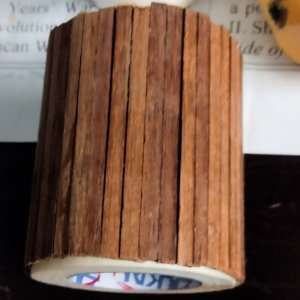

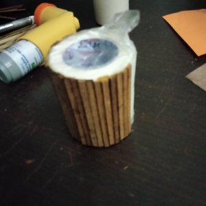

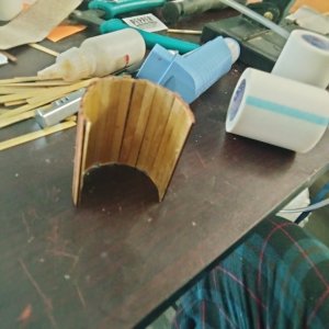

On the next one I think I will apply some if the 0.33mm strips horizontally to give some reinforcement. It will still be only 1.1mm thick. Now I have to wait to see if this is going to workIMG20251210060912.jpg
I did some sanding but don't know if I should put some PVA glue in the gaps and sand as a filler or if this is more realistic.IMG20251210210610.jpgIMG20251210210602.jpg

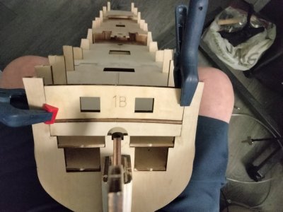

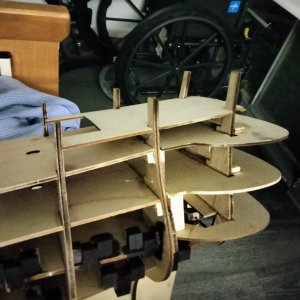

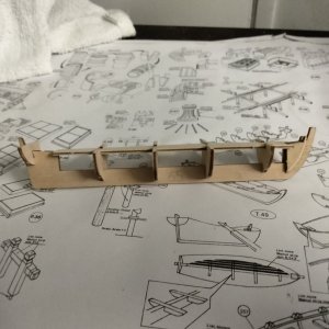

I think I finally have the stern assembled properly. At least it is pretty close.IMG20251215170646.jpgIMG20251215170651.jpg

I think I finally have the stern assembled properly. At least it is pretty close.View attachment 564006View attachment 564007
Indeed, you've done almost everything with the decks this time, and my advice has

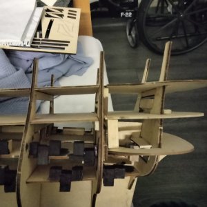

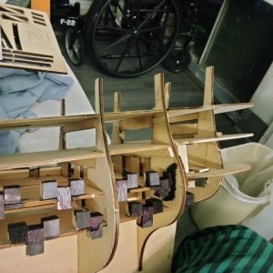

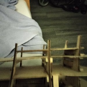

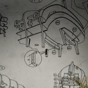

I'm not sure on the height of the upper deck at the stern. Parts 11D and 12D are replacements I made as my cute little OCD wife tossed the original parts thinking they were trash. I rand the deck parallel to the one below and used 21mm as a height based on the height shown on detail T14 (see second photo).IMG20251223050401.jpgIMG20251223051002.jpg
