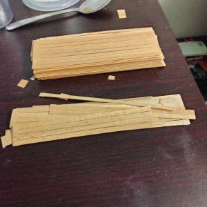

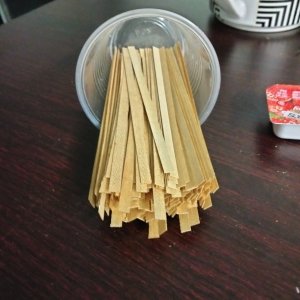

The strips provided for deck planking are only 0.3mm thick. I'm concerned that is too thin to scrape during finishing.
Ted, I had the exact same worry. So I measured these strips with a digital caliper- yup, 0.3mm- and compared them to the strips of sapele I used for second planking on my Occre Beagle- which were also around 0.3-0.4mm. In that case, 0.3-0.4mm gave me enough to be able to sand the hull (lightly!) to remove imperfections and get it smooth.
So there's enough material in 0.3mm to give us scope for a bit of light finishing.
Ok, you can see light through them if you hold it up in front of a lamp.

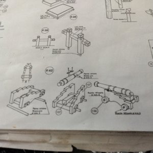

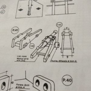

I'm searching for the next mini project I can do while hospitalized and settled in on the cannons. I'm hoping @AllanKP69 could send me some details in the gun carriages. The speciality book I bought on sprite sails ships fails to list cannons IMG20251202105912.jpgIMG20251202105933.jpgThe totality of information given is in two details. No rigging is indicated anywhere on the kit.
I want to provide rigging and all the hooks and rings that should be there.
I also noted that the front wheel axles are shown in a wood channel on the smaller cannon and both axles on the larger. Should i make these channels or should I use a solid block and drill the brass rods axles and glue into place
I found Allan's recommendations when I was building the Jalouse and want to build to that level. The cannons provided appear to be made of aluminum. I need to research finish on aluminum
Furthermore, the cannons came without reunions installed. I don't see any other aluminum colored stock in the jit. I'm assuming I will have to purchase aluminum stick to manufacture reunions. Otherwise differential coloring in the cannons vs reunions.
