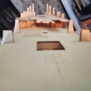

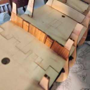

At this point I have several areas of concern.

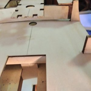

The false deck above the aforementioned false deck seems to be short or too far after to cover the bulkhead wall. Nothing in the plans show this wall in place. The false deck fit in place without any modifications except sanding of soot from the part. The frames are perfectly squared. Further more when the false deck piece aft is fitted it also appears to be too far aft.17626133376424361406105800764940.jpg
When temp fitting the main mast it has several degrees of rake. The only drawing that shows the mast in side view is the rigging plan. This plans shows no reference to the keel that would allow me to determine if the masts.have rake.
All of these problems with false deck fitment and mast installation with out rake would be solved by moving the false deck forward.

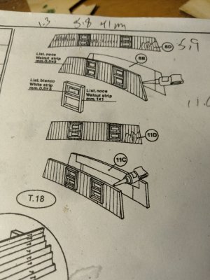

I have no quidence or reference on how wide to make the doors on the other main deck bulkheads. The only detail available is an isometric drawing. See below. I spend more time thinking about how to build my model than building it.17626150798011659280021517191116.jpg
Idiot time again. I built the door in the wrong bulkhead. I can modify this and frame seven bulkhead later.

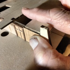

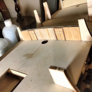

I cut the ends of part 7B and glued them on 8B to swap their locations.IMG20251108085702.jpg

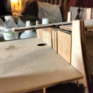

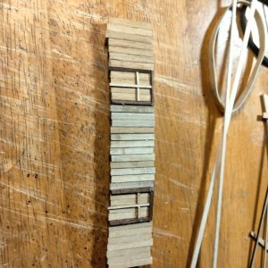

I put a coat of Minwax Golden Pecan on the wall and glued into place. I haven't decided on finish for the entire model but this part will really not be visible as the bulkheads fo in front of it and a deck above .17626214039124883913961780312654.jpg

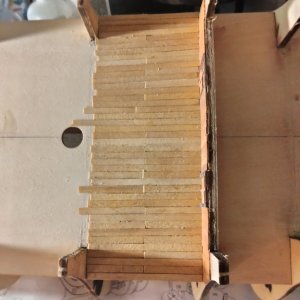

I just snapped a photo of the deck planking. It is so thin you can see light through it. IMG20251109061306.jpg

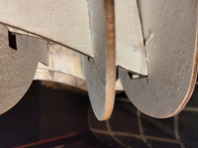

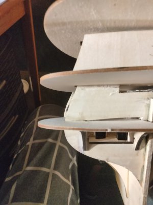

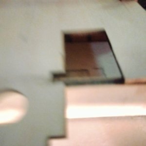

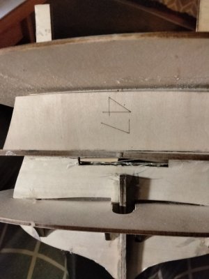

This time I have the lower two platforms installed perfectly. I think. The upper platform is a little high. Note the gap at the top of part 47.17628645983577154581308207160931.jpg
The problem is exacerbated by me having lost part 12C and having to remake it without knowing the height of the part.
Another problem is that the edge profile of part 47 doesn't match the edge of frame 12.

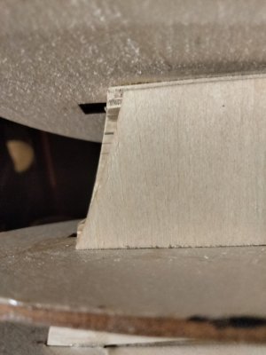

And finally part 47 is too wide to conform to the tapering of the hill at the stern.17628650047514666609167240711561.jpg17628650291963083254568035228772.jpg
Note how part 47 does not fall in line with frame 12 below.
