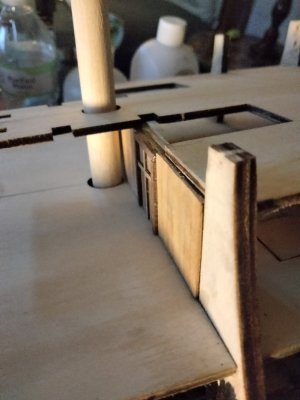

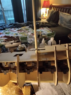

At this point I have several areas of concern.
The false deck above the aforementioned false deck seems to be short or too far after to cover the bulkhead wall. Nothing in the plans show this wall in place. The false deck fit in place without any modifications except sanding of soot from the part. The frames are perfectly squared. Further more when the false deck piece aft is fitted it also appears to be too far aft.17626133376424361406105800764940.jpg
When temp fitting the main mast it has several degrees of rake. The only drawing that shows the mast in side view is the rigging plan. This plans shows no reference to the keel that would allow me to determine if the masts.have rake.
All of these problems with false deck fitment and mast installation with out rake would be solved by moving the false deck forward.
I think I need to finalize/complete the finish on this wall before proceeding. The decks are a different wood. If I stain this wall after deck installation I may get bleed.through at the wall/deck junction.
Please pardon the unmade bed in the background.

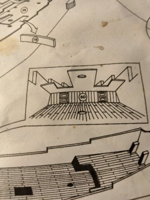

I have no quidence or reference on how wide to make the doors on the other main deck bulkheads. The only detail available is an isometric drawing. See below. I spend more time thinking about how to build my model than building it.17626150798011659280021517191116.jpg
Idiot time again. I built the door in the wrong bulkhead. I can modify this and frame seven bulkhead later.
I don't see the pint in putting doors on frame 8 if y
It is to be blocked by frame 7
Maybe my mind has aged to the point where I m not capable of building this model but it is my main source of enjoyment at this point in life l
