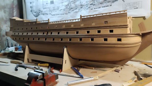

I've finished sheathing the sides below the quarterdeck. I still haven't decided what to finish the forecastle and quarterdeck with. The blue hornbeam issue is still unsolved. I'm leaning toward mahogany, which I used for the lower hull. But I still have work to do on the forecastle and head, and I've also thought about using padauk (a solid red material) to frame the gunports. I'll also use it later to make the inside of the gunport covers, so I don't have to paint them.

Nevertheless, I decided that I would not paint the hull of the quarterdeck and stern blue. I stopped at a red tree. I have just the slats left, which I sheathed the hull with below the waterline. After I cover it with tung oil, there will be a dark red shade of natural wood, I think gilding on jewelry will look good.

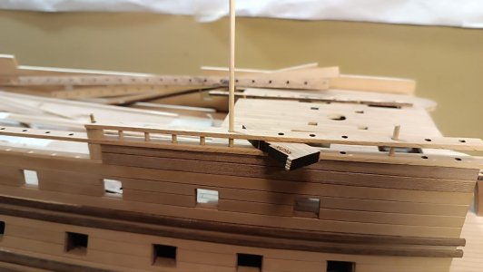

I started working on the tablet. I show you where to attach and which parts are designed for this purpose. There were questions about who didn't have instructions, and there were a lot of ambiguities in the instructions. Of course, the photos are just approximate calculations, you will need to adjust everything in place, but still.
These are the details of the gunwale by numbers. Parts without holes 146, 147, as well as 152 and 153 are glued to the gunwale itself, and then drilled.
The walnut slats are already glued to the finished gunwale rails and cover the rack openings. I recommend gluing them after completing all the basic work on the hull and deck. This way they will better preserve their appearance.
I hope everything is more or less clear in the photos. The only remark about the details of the most solid beech gunwale is that the slats are too thick — 3.3 mm. According to the drawing, their thickness should be from 2 to 2.5 mm.
I've assembled it in rough form. Of course, everything needs to be adjusted to fit. The planks were initially cut with a slight allowance. The shaded areas in the top view will need to be removed later. The Chinese messed up the vertical posts here too; they're 1 mm smaller in diameter than the holes in the gunwale planks and dangle loosely. Life is a pain. I also bent the walnut plank for the top of the transom with a soldering iron.

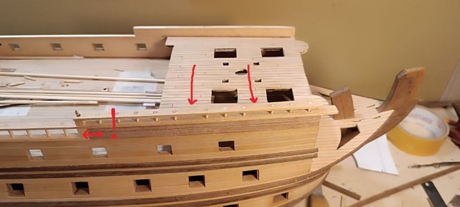

I continue to work with the tablet. And then the Chinese again made a mistake with the dimensions and holes on the slats. They just copied from Mantua. And everything would be fine, but the guns on the forecastle are too long and the round porticoes for them will be located where I indicated with the arrows, otherwise the carriages will rest against the hatch grating, and this will happen if they are assembled as is. Initially, when I took the dimensions of the inner sides of the gunwale and laid them out higher, I immediately noticed this and shifted the slats a little back. Who will proceed from my size, take this into account. But if you decide to redesign the guns and carriages by reducing them, then in principle you can not follow my advice, but do it as it is, but then recalculate the markings of the inner sides of the gunwale according to the drawing, and do not blindly follow my alterations and measurements of the sides.

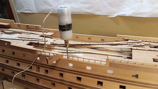

By the way, by the way, if you noticed, I not only glued the end posts, but I drilled through them by inserting a brass rod into them and connecting them to the side of the gunwale, I think it's more reliable than just gluing.
