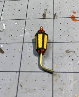

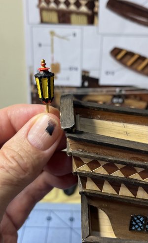

Starting with step G, the first task was the stern lantern.

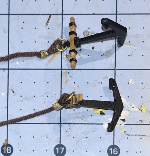

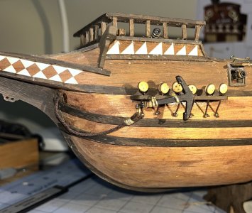

The anchors are next, each made of two pieces of Britannia metal, which required significant sanding. I painted the shanks and associated parts black, while the stocks were painted medium brown with black bands.

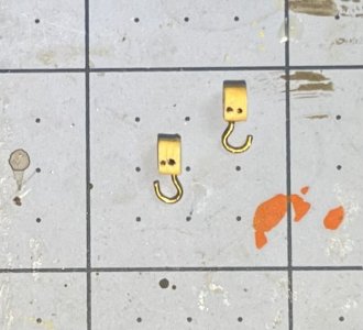

After gluing the anchor together, I opted to make a hook to connect it to a double block, as would be used on a galleon, instead tying it to the anchor as detailed in the instructions.

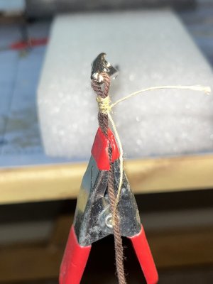

The anchor rope goes through the ring and is seized to itself, marking it as my first attempt at seizing. Instead of tying the anchors to the front channels as instructed, I added two ring bolts to each channel and tied the anchors off to them.

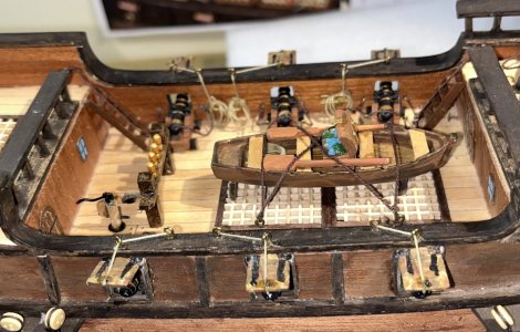

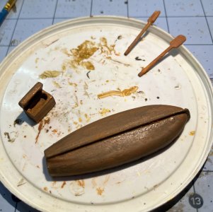

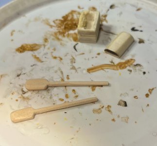

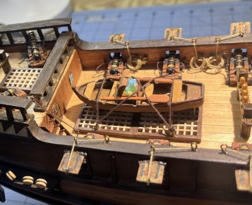

Moving on to the lifeboat, I glued on the four benches, then, I added two oars, a rope coil, and a treasure chest. After all, it is a pirate ship.
The treasure is tiny bits of sea glass I found on the beach (another hobby of mine).
After arranging and gluing the boat's accessories, I drilled four holes for the eyebolts to tie down the lifeboat. On the third hole, my pin vise broke, so I used a Goxawee (Dremel) for drilling.

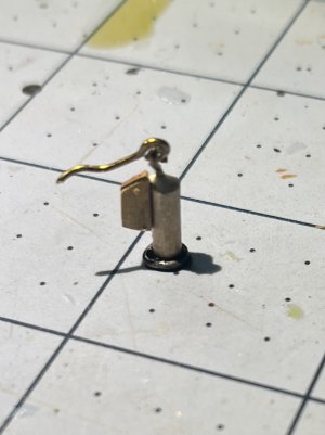

Lastly, I worked on the bilge pump.

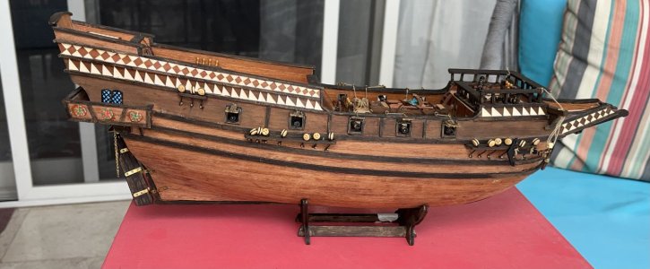

That does it for section G; rigging begins next. Since I only have about a week left in Mexico, I will hold off on starting it. I will look through all my notes to see if there was anything else that I wanted to do that was outside of the instructions.

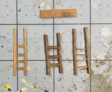

One of the things I have wanted to add for a while is a “plank.” Ok, I know they did not really exist, at least did not exist in mass, but I wanted one. So, after a little research about what they may have looked like, I had to find a place for it. The best place was on the starboard side of the main deck, between the front two cannons. The plank was the easy part, (three pieces of veneer glued together) but I needed a ladder of some sort that the victim would have to climb to get to the plank. I made three different ladders and did not like any of them. So, I am not sure if I will add it or not. Only time will tell.

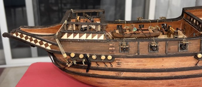

The next thing I wanted to add was a pilot ladder on the hull. I decided on it being placed on the main deck on the port side, right by the stairs to the fo’c’sle or foredeck. So, a person would climb up the “ladder,” then step onto the channel, then climb up and onto the ship. They would then step onto the stairs to get to the deck. I have seen ropes that were either attached or thrown over when people were boarding. I will have to decide if I want them or not.

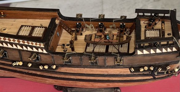

Next up are the eyebolts located at various locations around the ship; 2 on the quarter deck, 4 on the poop deck, and 4 on the bulwarks (2 per side).
The biggest challenge with the eyebolts is that my pin vise is under the weather so drilling the 10 holes will take a little bit longer than they should.
The McGuyvered pin vise worked well enough to drill the 10 holes, and then I glued an eyebolt into each one.

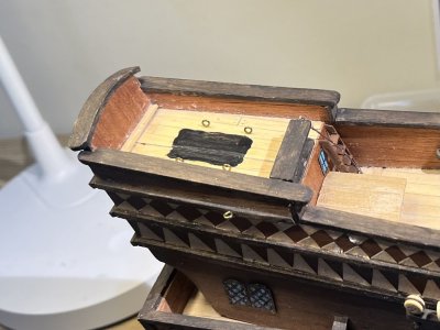

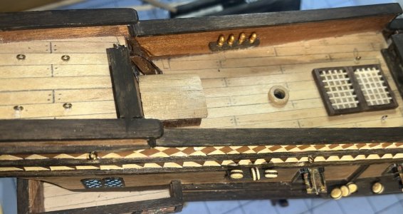

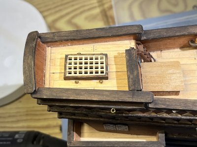

Last up of my list of “extras” is the “extra” grate up on the poop deck between the eyebolts. I saw this on Baltic Submariner’s build log on Model Shop World. I know on a real ship this would not be a suitable location for a hold, but this ship is not real so I can do whatever I feel like. And I like the look of it. Without it, the poop deck would be completely empty space.
I tried several of the leftover pieces of grate and found one that is 15mm x 25mm. I sand the edges and trim them off with some walnut lumber and put a coat of satin varnish on it. Before glueing down the grate, I paint the deck that will be covered by the grate black to give it some depth
