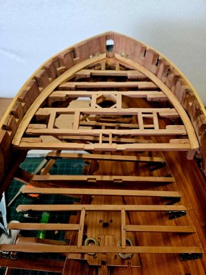

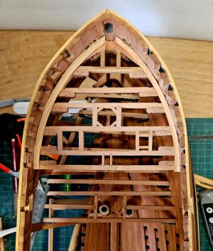

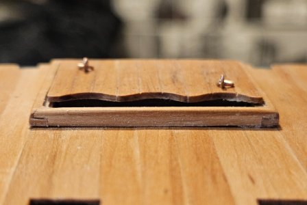

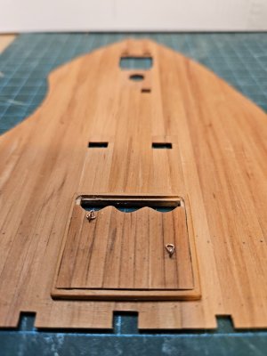

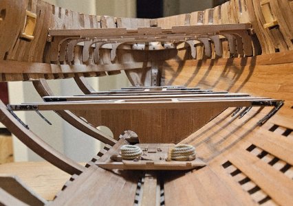

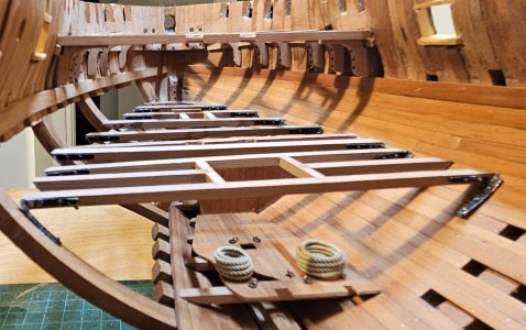

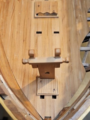

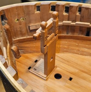

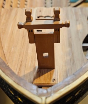

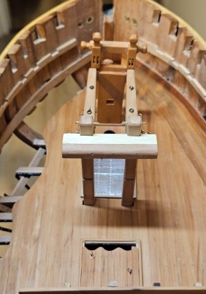

Good evening dear friends
In the Last week I went back to work on the decks in the bow.
I installed the crossbeams for the middle deck, placed the deck on it and the boundary wall (both without glueing).
I will let the pictures speak for themselves.
Good night
20260314_152604.jpg20260314_152631.jpg20260316_220325.jpg20260316_220631.jpg20260316_220652.jpg20260316_220717.jpg20260316_220755.jpg20260316_220813.jpg20260316_225156.jpg

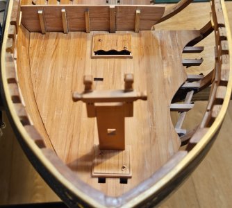

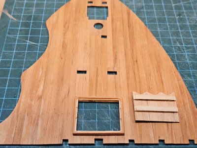

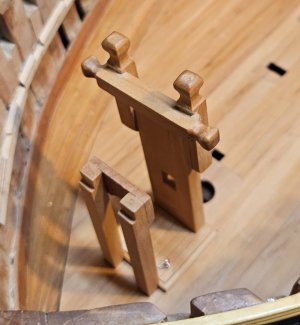

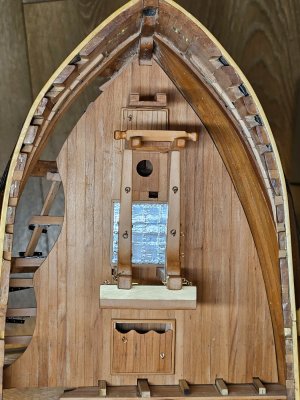

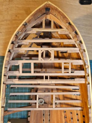

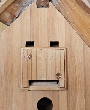

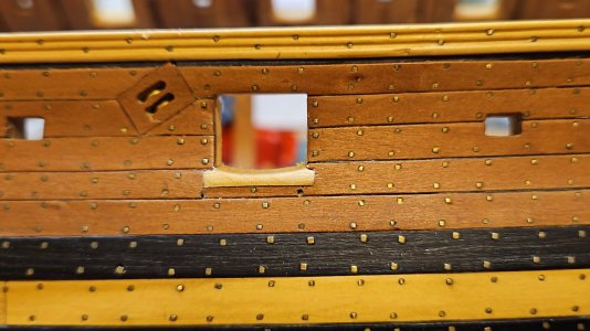

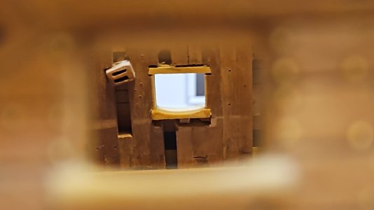

First I corrected the installation angles of the bottom plates of all the gun ports.
In the last few days I have taken another small step forward in preparing the parts that make up the decks in the bow.
With the help and guidance of our dear friend marsalv, I understood how to build the entrances on the middle deck and they were installed with the rest of the parts.
In the coming days I will continue to finish assembling the remaining parts and their adjustments and synchronization with the upper deck in the bow.
20260323_222343.jpg20260323_222445.jpg20260323_222600.jpg20260325_195009.jpg20260325_195244.jpg20260325_195420.jpg20260325_195447.jpg20260325_195822.jpg20260325_200256.jpg20260325_200459.jpg20260325_201517.jpg20260325_201550.jpg20260325_202249.jpg20260325_202511.jpg20260325_202630.jpg
I will let you be impressed by the pictures, good night.

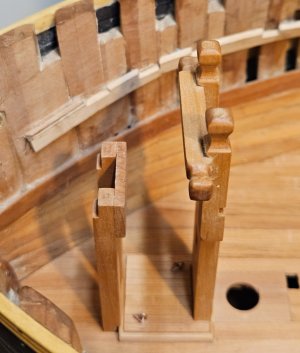

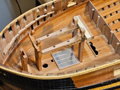

View attachment 586705View attachment 586706
View attachment 586690View attachment 586691View attachment 586692View attachment 586693View attachment 586694View attachment 586695View attachment 586696View attachment 586697View attachment 586698View attachment 586699View attachment 586700View attachment 586701View attachment 586702View attachment 586703View attachment 586704

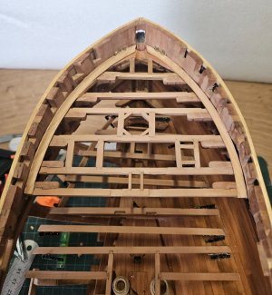

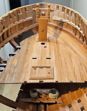

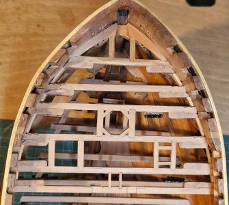

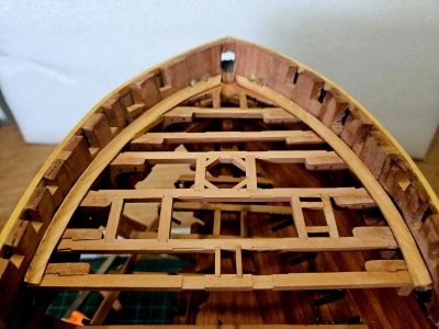

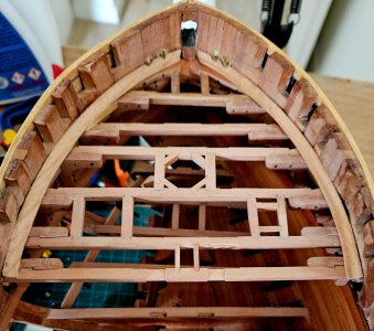

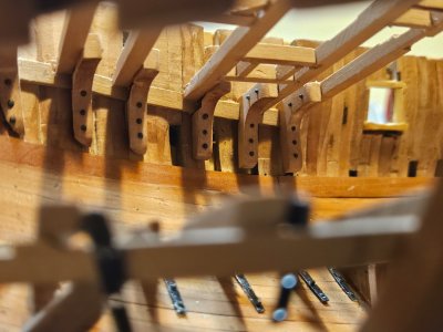

Hello dear friends
I would like to thank you for the likes, smiles, and words of support throughout the construction process.
In the last few days I have installed the cross beams of the upper deck at the bow, including the support knees as well as the concave panels that enclose the deck.
Forgive me for my poor photography skills, which sometimes give the illusion of lack of parallelism or curvature.
20260327_000644.jpg20260327_000739.jpg20260327_000833.jpg20260327_001018.jpg20260327_001152.jpg20260327_100619.jpg20260327_121445.jpg20260327_121450.jpg20260327_121456.jpg20260327_121823.jpg
