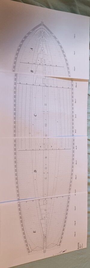

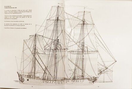

This monograph is based on the plans of a corvette started by builders Ollivier father and son in the years that will follow the appearance of a well identified type.
This monograph details the architecture, the fittings, the equipment and the rigging of a corvette of 12 guns of years 1745. The plans are at 1/36 for a relative ease of execution .

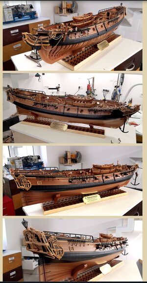

In addition, I will help with the construction diary of our good friend Giampy65, who has finished building a very beautiful model

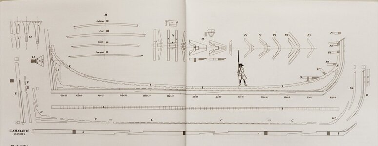

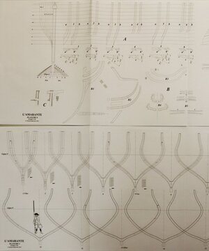

Screenshot_20231101_134044_Chrome.jpgIMG_45041.jpgScreenshot_20231101_134309_Chrome.jpgIMG_45081.jpgIMG_45161.jpgIMG_45231.jpgScreenshot_20231101_135406_Chrome.jpg

I read very carefully the accompanying book for the monograph's sketches.
I also thoroughly read the construction logs of our friend Tobias and Giampy65.

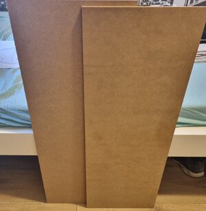

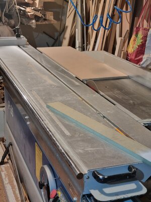

In the last few days I made the wooden boards required to make the jig for the hull of the ship.
I made a bottom panel 1 cm thick, 33 cm wide and 83 cm long. The top panel will be 6 mm thick, 32 cm wide and 82 cm long.

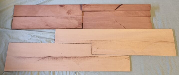

I also sawed pear wood boards for the keel as well as basswood boards for the ribs. I have not yet decided which tree I will make the ribs from, since there is no pear of the European variety in my country. I intend to prepare a sample rib of both types and then decide also according to the scope of raw material that will be required

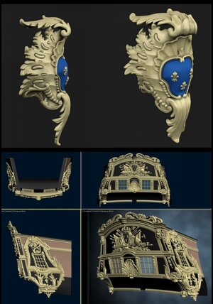

2 years ago, I made a fairly accurate interpretation of the Amarante's stern and bow decorations.
If you'd like a little inspiration, I can send you some larger images.
Bernard
Cher Bernard, Je suis vraiment émue par l'esprit de générosité et l'envie de m'aider ! Je serais très heureux de recevoir toute aide possible de votre part ! Dans quel format ces images ont-elles été créées ?
Dear Bernard, I am really moved by the spirit of generosity and the desire to help me! I would be very happy to receive any possible assistance from you! In what format were these images created?

These images are rendered images of the 3D model created with 3DsMax. I can make them in any desired format and size.
Cher Bernard,
Merci beaucoup pour votre volonté d'aider à résoudre ce problème. tout format de fichiers sera accueilli avec un grand merci. J'avoue que je ne connais pas comment utiliser les fichiers 3DsMax, mais je dois dire que vous avez fait un travail très impressionnant et magnifique !!! Je serais heureux de recevoir de votre part de magnifiques designs dans tous les formats possibles et en mettant l'accent sur un format qui m'aidera à les utiliser dans ma CNC domestique que j'ai et qui a été mise à niveau ces jours-ci vers 4 axes. ainsi que tout fichier pouvant aider à l’impression 3D. Je vous enverrai un message personnel en utilisant l'e-mail sur notre page de forum pour vous donner un e-mail personnel pour une correspondance ultérieure sur le sujet.
Cordialement Shota
Dear Bernard
Thank you very much for your willingness to help with this matter. any format of the files will be welcomed with many thanks.
I admit that I am not familiar with how to use 3DsMax files, but I must say that you have done a very impressive and beautiful job!!!
I would be happy to receive the beautiful designs from you in any possible format and with an emphasis on a format that will help me use them in my home cnc that I have which these days has been upgraded to 4 axes. as well as any file that can help with 3D printing.
I will send you a personal message using the email on our forum page to give you a personal email for further correspondence on the subject.
