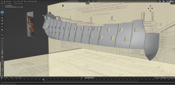

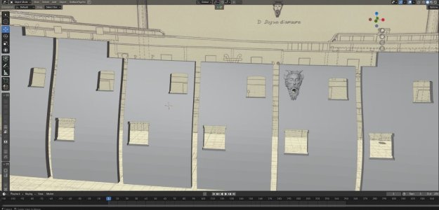

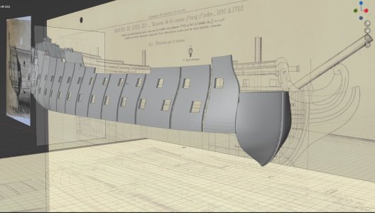

Hello
Little progres on hull. I divided it on much larger are, certainly it will increase the printing time, but reduce the filling areas to minimum or zero.
I was a little worried about whether they'd fit in the printer, but I can easily fit up to 1/48. I also did carving that looks like a devil face for main sail tackle rope

Hi:) I have just realized the plans in the background aren't exactly like Tanneron's model; so which one are you basing your model on? From what I see here, it is closer to Tanneron's model......

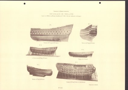

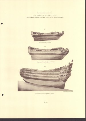

I want to make it more similar to Tanneron's, but not exactly the same. I plan to add some details that Tanneron didn't include in his model eg. I added curtains at the stern carving. Could you describe some differences between this plan and Tanneron's model? I thought the plans of some of the French ships in *Souvenirs de La Marine* were taken from models at the Paris museum. The plan is not marked as The Brilliant, but this long description in other plate points directly on Tanneron's model. The names in Souvenirs de La Marine aren't particularly consistent: on one page, the Soleil Royal under construction is referred to as “108, 1st-rate,” while on another it is called Soleil Royal 120. In addition, the plans were displayed alongside other Tanneron's models such as L'Agréable and Capricieux

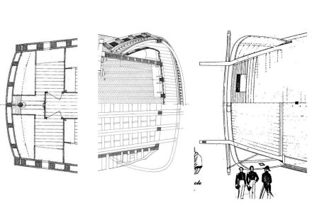

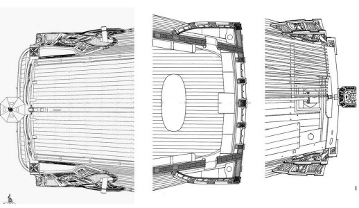

The rear surfaces of the sterns were never flat when viewed from above.
They were always more or less curved, as shown in the following examples.3poupes1.jpg3poupes2.jpg
If you look at your devil face and measure the distance between the portholes and where you make your panel vertically rise a bit, you find that it it closer to the Tanneron model than the plan in the background; the plan itself is not necessarily from the Brillant but rather a more generic plan of a 60 canon shp of the 1690 period. From the 1670's to the early 1700's there wasn't a lot of evolution in the hull shape except for very lightly better flowing slight rise toward the rear as the ''straightening'' of the hull construction was the new standard for the ship builders. So I would suggest you keep the Tanneron Brillant as your main reference for your buld.
Now, as for the naming of the different drawings, you need to keep in mind one important thing; we do not know who drew those, nore do we know when.... In that respect, two drawings carrying different file names with the same illustration may very well simply depend on who gave it the file name while keepeing track of the works' inventory and during which period.......There are many mistakes in the filing of drawings and misinterpretations of the actual artists who drew them. One case being the museum's model called the Louis XV, and that same ship on a drawing being called the Royal Louis.....The same is true with mistakes on the 1668 Royal Louis drawings being written Monarque on them. In the case of your example, the 1670 Soleil Royal was registered initially when Colbert and Duquesne decided to build the 4four royal ships as a 120 canon ship, which it never became. The labeling however remained throughout time, and it's only when you find all the information about the evolution of the initial constructions and set up that you realize what they really were. The Tanneron ship is a very beautiful exercise in 1670 Soleil Royal stern ship decor, but the hull shape, and the bow's decor, aswell as the top gunport row are not from the ship; The front and the top gunport rows represent a style more related to the beginnig of the 1680's and beyond; the same is true for the brillant as far as the top gunport row; now, the Brillant's career was so long (25 years) that it must have ha some refit during its time; it is quite possible that those top ports were modified with the new style as with all the ships of that 1680's period; the same is true with the decor. It could be that the initial decor ( with the curtains) was in face the right decor, but by the time of the first refit, it was modified because of the rott in the wood carving, or some other reason; Tanneron's Brillant could also be any of the three first ships which carried that name in that period....Initially from 1671 to 1678; the name was tranfered to another ship from 1678 to 1687; and to a new build in 1688.....up to 1698.....All those ships were very similar in their appearance and construction....
