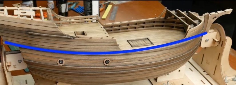

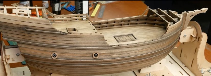

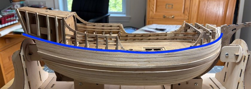

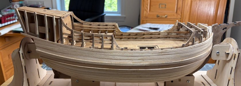

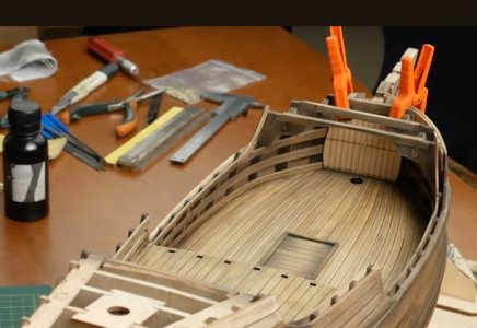

:oops::oops: I have a minor problem :oops::oops:
I've got the same error on both the Port and Starboard side. I stopped my planking progress on the Port side because I thought I had missed placing a plank. I guess I'm consistent because I have the same error on the Starboard side.
At first glance the planking looks just fine
But, there is a bit of a gap almost the width of the last plank I placed.
These are screen shots of Pavels build sequence and everything is nice and flush.
Yup, it's "imagineering" time.

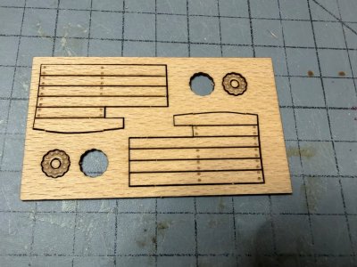

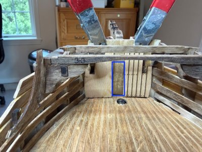

While I'm pondering problem #1 I managed to find another. I watched Pavel's video on cutting in the gunports and managed to get those right. I then moved on to the Hawser ports. Looked up the video, watched the process, found the parts and then :oops:.

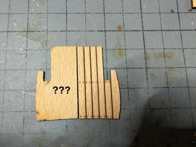

There are two pieces in the kit that cover the bulkhead at the stem.
The mini flat with the two pieces
The test fit prior to adding to the hull
Test fit against Stem bulkhead
There is quite a gap. Fortunately this portion will not be to visible once the upper deck and the windlass etc. are added.

Hmmm. There are thirteen planks in Pavel's version and only twelve planks on yours. And he is behind a beam - are you in front of that same beam? Of course, you are both just about the same distance from the hole in the deck...so that seems good. Again...hmmm...
