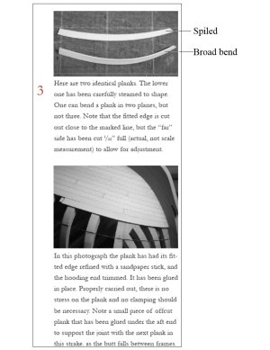

Trimming the upper edge on the first plank will work if the gap is not to wide and the curve of the bottom edge of the garboard strake is not too deep. The amount of material you are allowed to trim off is limited by the width of the plank. A plank should never be tapered to less that half of its full width. It this is the sutuation, here is what you do.
In order for the first plank's top edge to lay alongside the garboard strake, one of two things must occur. 1) the plank will twist, which is unacceptable, because it will not lay flat on the frames. 2) the plank must be BENT sideways, as if it were cut in a curve from a larger sheet of thin wood. This can be done in one of two ways. Spiling, which is the soaking of the plank, and forcing it to bend on it's long axis using a jig that prevents the plank from twisting as it is bent. As long as the curve is not too tight, it can be done carefully without splintering the wood. The third option is to cut a custom shaped, curved plank from a sheet of wood, using the paper pattern taken from the lower edge of the garboard strake (mentioned earlier) as a template.
Remember that in planking, the planks should be trimmed, bent, and fitted so that there is littel to no stress of force applied when they are fit to the frames on the hull. You shoul not rely on glue and clamps to hold springy planks in position. First, struggling to force a plank into place will leave gaps between the planks, no matter how hard you pin or clamp it down. A plank could also pull away from the edge of the frame before the glue sets, creating a gap underneath that you cannot see, but will affect the shape and strength of the hull at that spot. If you properly trim and pre-shape planks, and bevel the edges to prevent gaps, installing them on the hull is super easy. You will actually save time, and the joints between planks will have tight seams. Also, you will not be frustrated by uncooperating planks, which is a major reason why beginners give early when trying to build wooden model ships. It's all about patience and proper technique.
Read about spiling in the article attached.
Further to Kurt's great information...... the photo above and below shows a spiled plank which has been cut from a sheet of wood then broad bent. If the kit you are working with includes sticks of wood for the planks, you have to edge bend differently using heat or water and heat. This four part video shows this pretty well. Part one is below.
Keep in mind every plank has a slightly different shape so it takes a while to do them all. Have you looked at planking expansion plans? You will see every plank is slightly different. If the plank is done correctly, no nailing or clamping is needed even using PVA glue. Less than a minute with finger pressure is all you need.
