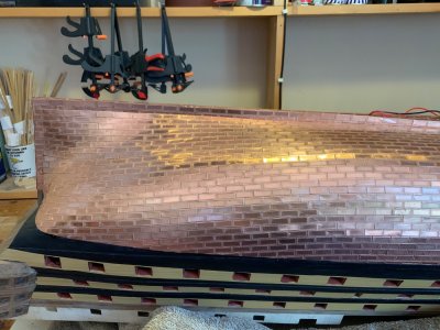

Decided to tackle the copper plating next
I would imagine I will be spending the next month or so completing the hull if I do both sides. Has anyone any thoughts or guidance as to wether it is better to do both sides or leave one side with just the walnut 2nd planking

Thanks a lot John and Peter for your comments. Have decided to copperplate both sides so I don’t think I will be adding to by build log for quite a while yet, and in answere to your question about the copper plates - yes, they came with the Caldercraft kit

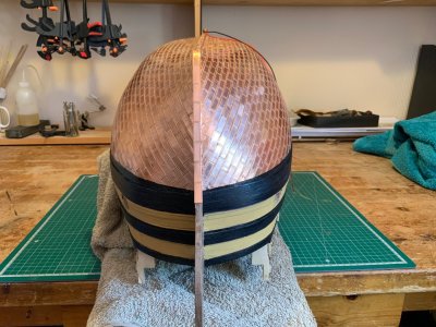

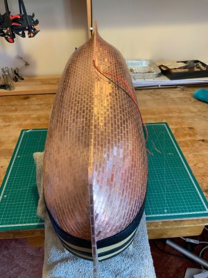

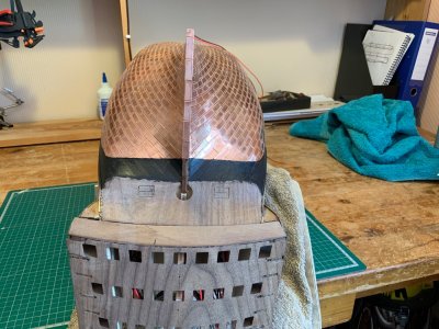

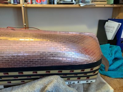

Have progressed a bit, with the copper plating but found that as the plating gets closer to the water line and starts to curve a bit then the staggered brick pattern was getting out of line so I countered this by shaving a small amount off the end of the copper plate with a craft knife, leaving the rivets still showing on both ends. This brought the stagger back into line until the shaving procedure needed doing again.
This shaving of the copper plate can be seen in the above photo on the two bottom rows on the right hand side.

Eventually the copper plating has been completed and after cleaning with acetone, polishing with a metal polish and coating with Rustins metal lacquer to prevent it tarnishing it doesn’t look too bad
