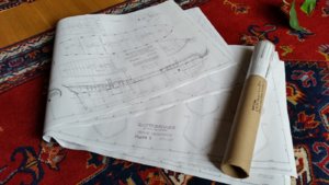

This will be my build log about the Rattlesnake build that I liked from the first time I saw pictures of Harold M Hahn`s models and model built by Janos.
I imagine this can be a pretty model even without carvings, this is something I'm not very good at.
The drawings were purchased through Navy Board Models, with great help from Winston and Chris Hahn.
The plans were sent to me rolled up in a cardboard tube, super, no folds
