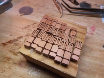

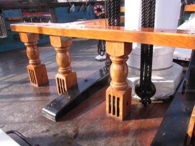

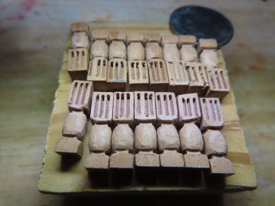

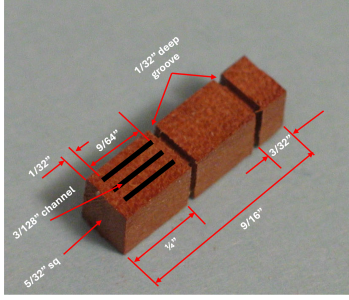

Following Robert Hunt’s practicum, Using the of 5/32" square Swiss Pear stock I from the supplemental wood package I purchased, I cut 15 pieces to 9/16" long. As shown in the practicum image P12.1-3, mine were no different. Then he stated he made crosscuts to set the limits of the center bolster. He did not state the method he used or how deep he made his cuts. I used my Byrnes saw with a 1/32” thick blade to cut 1/32” deep.

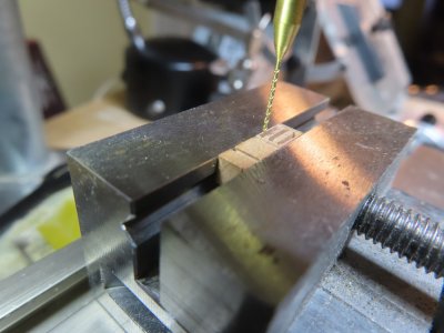

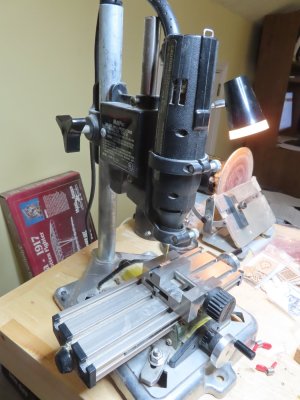

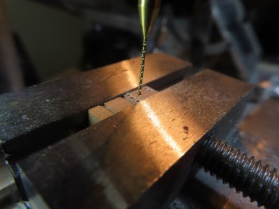

Using my Dremel tool with a #73 drill bit attached to my Dremel drill stand, with a Proxxon X-Y table, I had my poor man’s milling machine set up. I experimented with drilling the sheeve holes first and then the sheave grooves and vice versa. Although the pictures below show the holes drilled first, I found that drilling the grooves first worked easier.
Once that was completed, I formed the center bolsters. Mr. Hunt used X-acto blades to carve the bolsters. I would have loved to use my lathe to cut the bolsters, but this was a delicate and finely detailed task for the lathe, and I am a complete novice. Rather than practice with my limited stock of Swiss Pear wood, I chose to use needle files rather than an X-acto knife for better control. Looking at the photos, it seems I need to smooth the bolsters a bit more.
Nice job Jon. The sheaves look great. I can't believe you used a Dremel drill press for that. My wobbles so much, there's no way I could have gotten a straight line, even with the Proxxon X-Y table. As for using the lathe, you should trust yourself. make a cutter from a safety razor or some other fine blade. I lower than even a novice, when it comes to using a lathe and I managed to shape some pretty nice pieces. Of course, you've done a pretty awesome job here and just smoothing them out a little will look damn good
