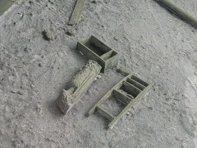

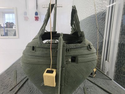

I don't know if you are aware but there are two models of the Swan or "Ghostship" in existence already but they are both in her present state. After that little project in the Baltic was completed, two models of the wreck were commissioned. One was placed in a Swedish university and the other sat as a display at the company I worked for back then. Fast forward a bunch of years and the model disappeared, the company was sold and I subsequently switched employer. At my new place of work, the other model turned up and I am now looking into restoring it and creating a better looking display case for it. This is currently the only picture I have but I am sure you recognize her :)
I do not know how accurately she is build in terms of ship construction but as the wreck sits, she is very accurate. If you wish, I can snap som more detailed pictures in the upcoming weeks when I have time to go over to the workshop.
I now work quite a lot with marine archaeology and there are quite a few of these around in similar or better state of preserve. We have an upcoming long term project to bring these to the surface with photogrammetry so hopefully there will be a lot more data available within the upcoming years.

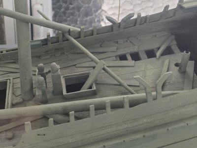

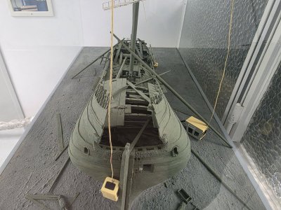

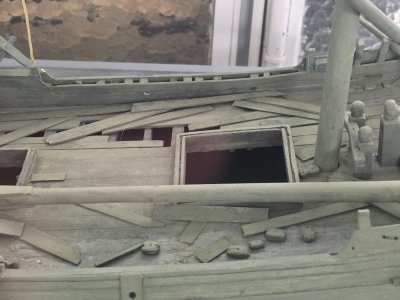

Hi,

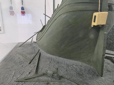

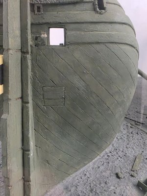

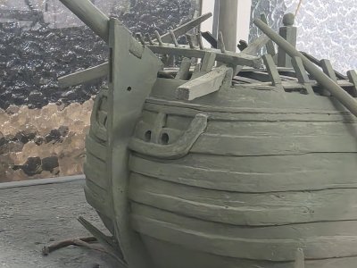

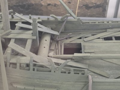

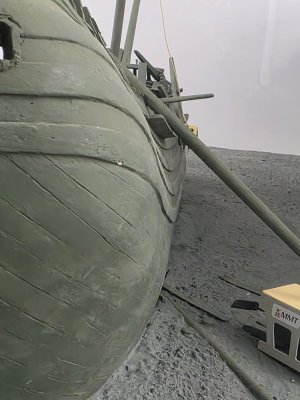

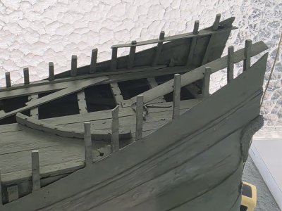

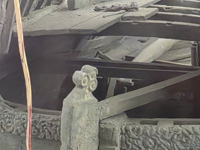

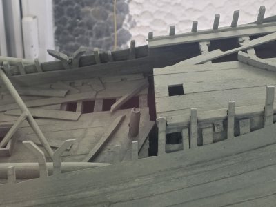

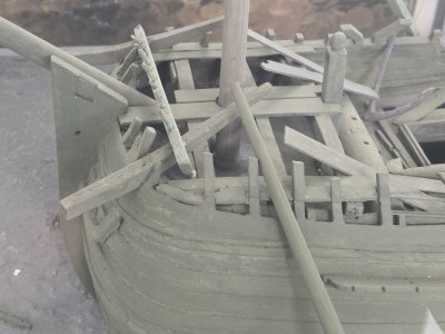

You are correct that the slice of MBES data is at the main cargo hatch. I have tried to source the original sonar data as the whole wreck was completely covered but as expected, it is lost. Our model however, I have found out that it was created from the sonar data and with the video as an aid. Looking closely, it does not contain the full internal structure where it is not visible for the viewer. Over time, the ROVs have fallen off the the lights have stopped working but I'll set that straight.
Here are some more images of the model. It is hard to capture the shapes on a mobile phone camera due to the lens distortion.
Note the bilge pump tube on the aft section of the main deck.
20261022_161427.jpg20261022_161431.jpg20261022_161434.jpg20261022_161439.jpg20261022_161446.jpg20261022_161508.jpg
I won't say all but most fluyts have the trefoil at the top of the rudder. If they do, they are Dutch.
I hope they are of assistance. :)
Edit: For some reason I can't get rid of the two duplicate images below.
Hi Erik,

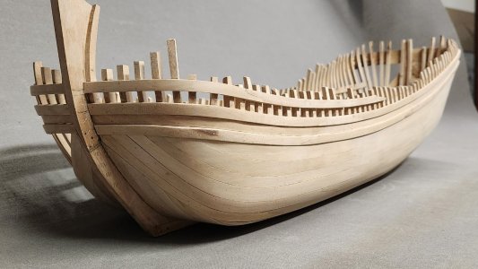

Many thanks for these pictures, these are extremely valuable to me. I directly see some things I maybe have to alter :-) .
Especially my decision to move my "scheerstrook" from the top two wales to the lower two wales has been a good one as confirmed by your model pictures.
The average width of the hull planks below the wales on my model is slightly bigger, but also on the model I expect that is an interpretation.
But see below some comparisons.
